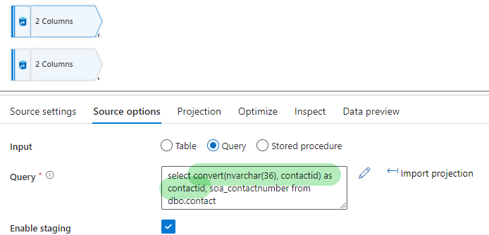

  4. Brandon Duncan 0 Reputation points
    2024-05-14T20:11:42.1+00:00
    If you're here in 2024 - On your source, convert the column when pulling down the data by specifying a query like this
