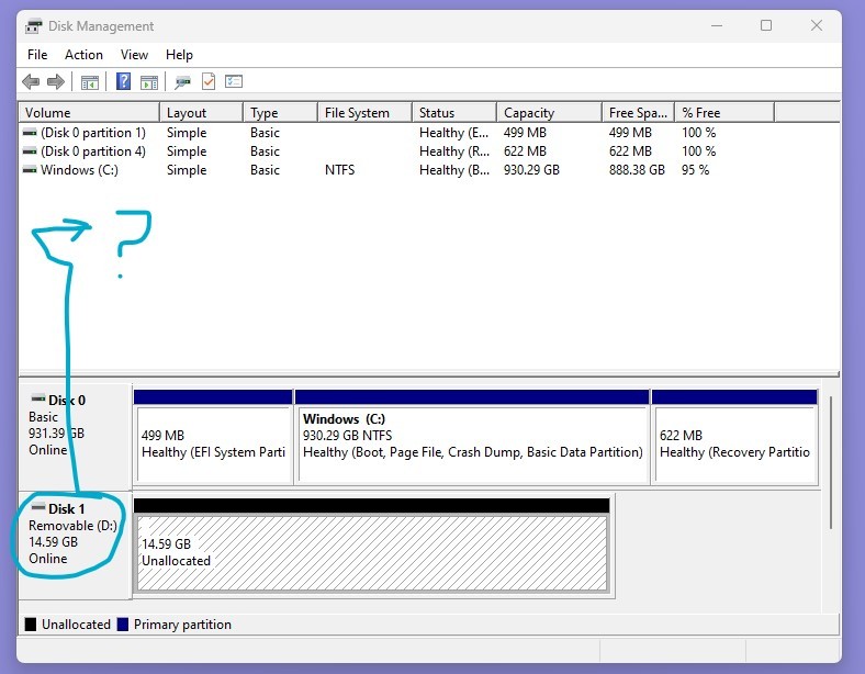

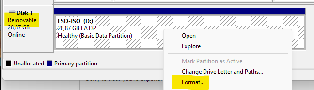

    Hi, Jim,
    Sorry to hear you're experiencing this issue.
    As the process to create a recovery drive has failed, the partition of your flash drive has been deleted and not recreated. In this case, formatting your flash drive should fix the problem.
    1-Right-click on Start then click on Disk Management
    2-Search for your flash drive at the bottom of the page(your flash drive will shown as removable device)
    3-Right-click on that and select Format then follow the instruction
    Alert: Make sure you select the right disk before format, this procedure will delete all files on the disk and cannot be undone.
    2023-03-29T08:36:33+00:00
    Hello Robinson,
    Thank you for your reply. It IS appreciated.
    I followed your suggestion but sadly the display I came across does not match yours. It shows these choices only
    Change Drive Letter and paths ...
    Eject
    Properties
    Help
    Just checking that there might be a reaction on the "Shaded" area to the right I clicked on this.
    The choices there were as follows
    New Simple Volume (Bold type)
    New Spanned Volume (Greyed out)
    New Striped Volume (Greyed out)
    Properties (Bold type)
    Help ( Bold type)
    I tried all of these to see if there was any reaction when pressed but there was none whatsoever.
    It then occurred to me that as the D Drive did not show in the area below where the Windows (C:) is as shown in this picture, then there could be no reaction at all ?
    With this in mind I removed the "faulty USB and replaced it with one that I knew was good.
    The result was that the replaced USB unit immediately appeared above those Disk 0 & C: AND in the place where the faulty USB is shown in the above picture.
    The choices that I described above also appeared as described and so I used the EJECT choice and the USB disappeared as anticipated.
    It would seem that there is a strong possibility that any data that is on the "faulty USB drive is totally lost.
    (Unless someone else knows a method to restore its use.).
    Thanks again for your kind assistance. It IS appreciated.
    Jim
