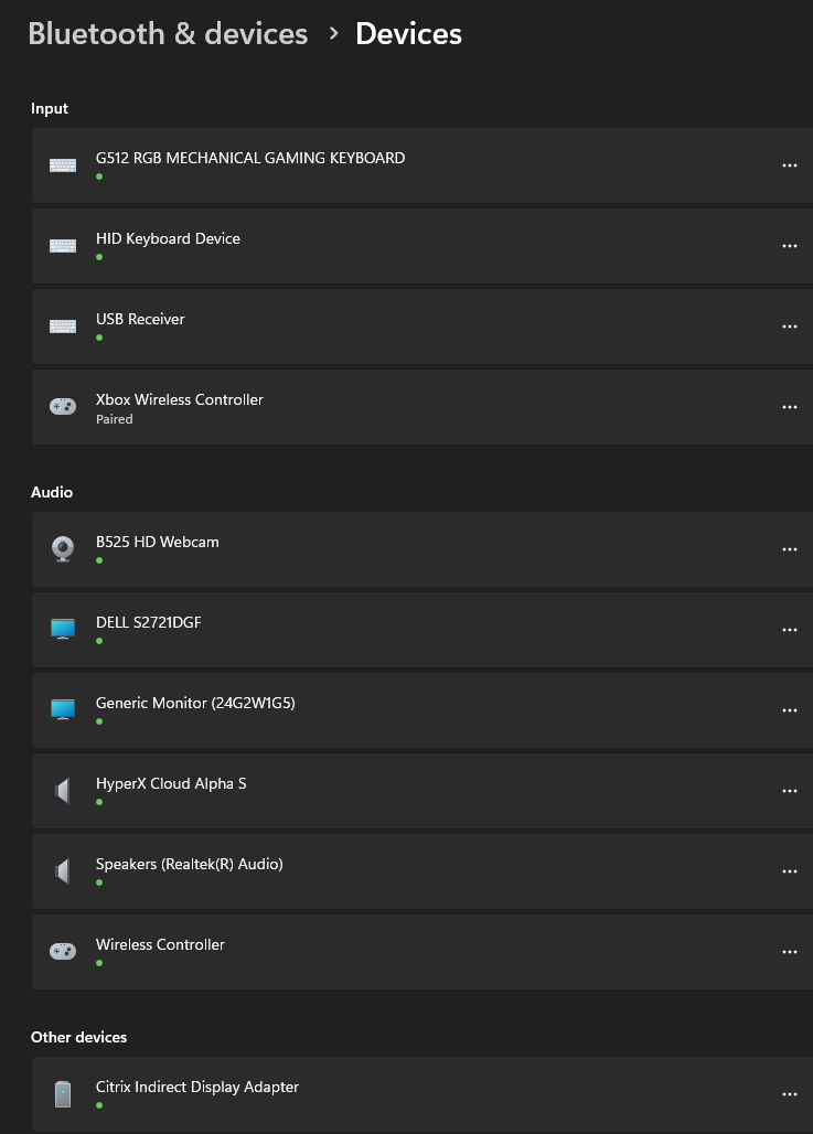

My PS5 controller used to work fine with steam even in spiderman and Guardians of the galaxy had haptic feedback. Suddenly is not working as it used to. When I try to play Hogwarts on steam when I press R2 repeatedly, it has a delay. I tried use it both via USB and via Bluetooth. When I open the Firmware PS5 program to check for update, the program is not responding. I tried in another computer and it is works fine. When I try to open Spiderman with the controller connected via USB, it freezes and won't open. I uninstalled the controller, I reboot the PC and still works not fine. It is recognized from my windows 11 (I updated from 10 to 11 and still it has the same issues) as audio device or as other device (if i disable it as audio) but no as input device as is my xbox controller.
Probably this happened after an windows updated or armoury crate upodates. I have asus MB. The same day that I have issues with my PS5 controller, I had issues with my Corsair keyboard. It wasn't recognized by iCue program so I can change the RGB. It made me frustrated not able to change rgb and keep flashing in my face so I changed the keyboard with Logitech that I had.

    I had no problems with steam games as steam helps to play the games with no problem. Now I was playing again Hogwarts via Bluetooth with ps5 controller and everything was fine. But when I connect via USB is not fine. Via Bluetooth when I go to the Bluetooth & Devices, I find my controller in the Input category. When I connect it with USB it is in the Audio category. If I disable it as Audio device, it goes to the other devices category.
