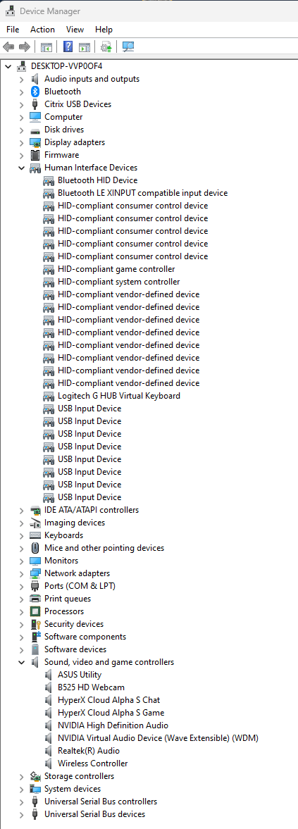

My PS5 controller used to work fine with steam even in spiderman and Guardians of the galaxy had haptic feedback. Suddenly is not working as it used to. When I try to play Hogwarts on steam when I press R2 repeatedly, it has a delay. I tried use it both via USB and via Bluetooth. When I open the Firmware PS5 program to check for update, the program is not responding. I tried in another computer and it is works fine. When I try to open Spiderman with the controller connected via USB, it freezes and won't open. I uninstalled the controller, I reboot the PC and still works not fine. It is recognized from my windows 11 (I updated from 10 to 11 and still it has the same issues) as audio device or as other device (if i disable it as audio) but no as input device as is my xbox controller.
Probably this happened after an windows updated or armoury crate upodates. I have asus MB. The same day that I have issues with my PS5 controller, I had issues with my Corsair keyboard. It wasn't recognized by iCue program so I can change the RGB. It made me frustrated not able to change rgb and keep flashing in my face so I changed the keyboard with Logitech that I had.

    This is my print screen

    After format my disk and installing windows again, no problem again. I do not know for sure what caused the problem. But I am not suggesting to do the same. I read somewhere that it is caused by CITRIX RECEIVER. I am using citrix for working. Could you let me know if dyou are using citrix too?
