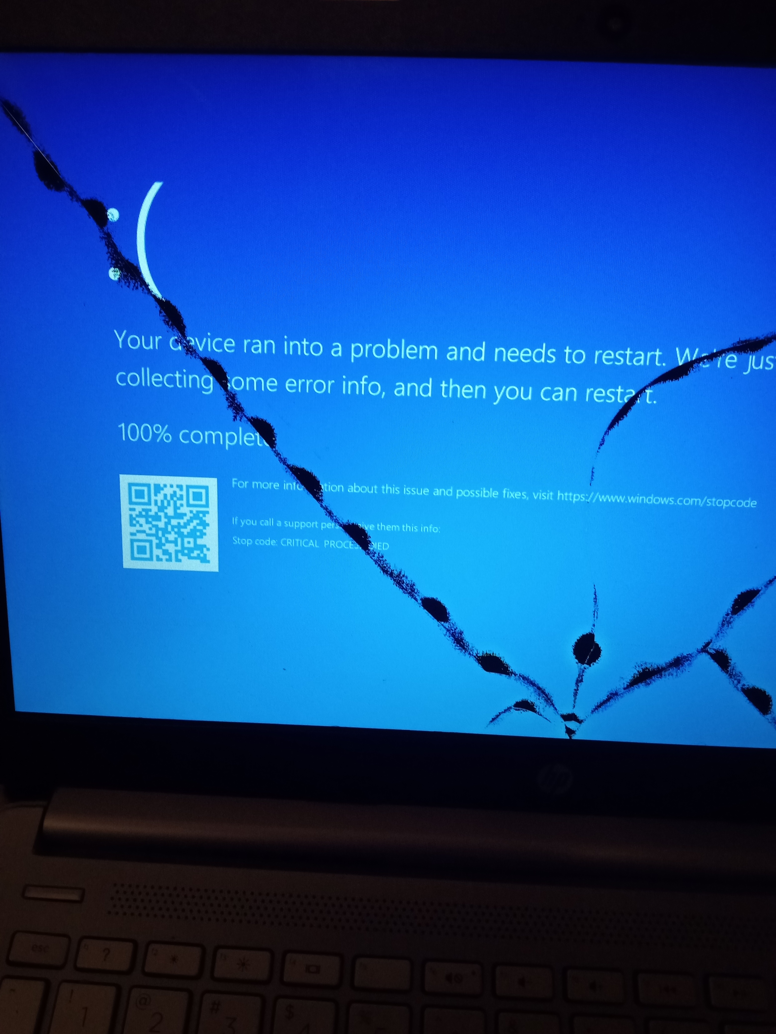

I really need help fixing this problem with BSOD and error code 0xc0000001
2023-03-25T01:00:01+00:00
This all started when I was trying to reset my windows 11 hp laptop because I had a problem with the audio but now I'm stop in a loop of BSOD and the error code Error Code: 0xc0000001 I tried every solution I have seen on the internet and tried with hp live chat. I can't enter safe mode either because it gives me the BSOD. I even tried resetting the whole laptop itself because I'm so desperate to just be able to use my laptop.
