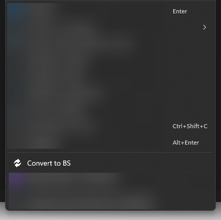

    I had same question. After an hour of googling random stuff I found an app in microsoft store called Custom Context Menu. It costs some money but it has unlimited trial. You are free to choose whether to buy it or use free trial, buy it to support author.
    With this program you are getting endless possibilities to mess with new context menu. You can select between matching folder or matching specific file extension (I've selected .png files), also you are able to match multi-file, and select any desired icon for context menu option.
    I added new option that I wanted for a long time on both of my PCs already.
    Github: https://github.com/ikas-mc/ContextMenuForWindows11
    Github page has links to MS Store.
    I hope my answer stops you from googling more. (since google has no really good answers for what I and TS wanted to achieve)Image
