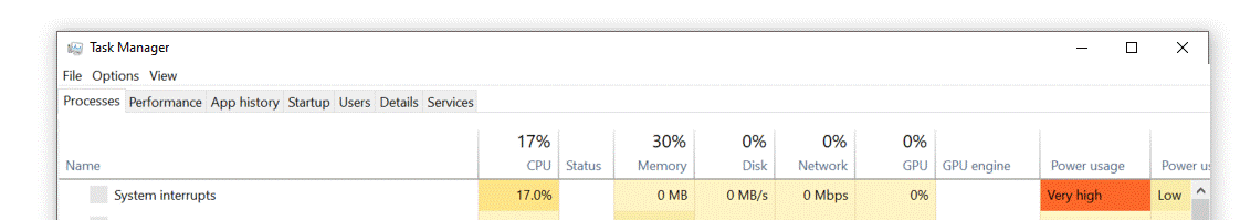

The comptuer has started to run slow, for now apparent reason. It is particularly bad when Teams is running. I have disabled GPU in Teams. While nothing is running System Interrupts often uses 17% CPU.

    Hi Luiz, thank you for your suggestions, but I am not sure they are suitable for the problem. I have tried them with no success. The problem is shown by the high usage of the CPU for System Interrupts and the high latency. I assume this is a hardware fault or defective driver somewhere, though I can't find it, rather than just a general performance issue.
    Thanks for your help.

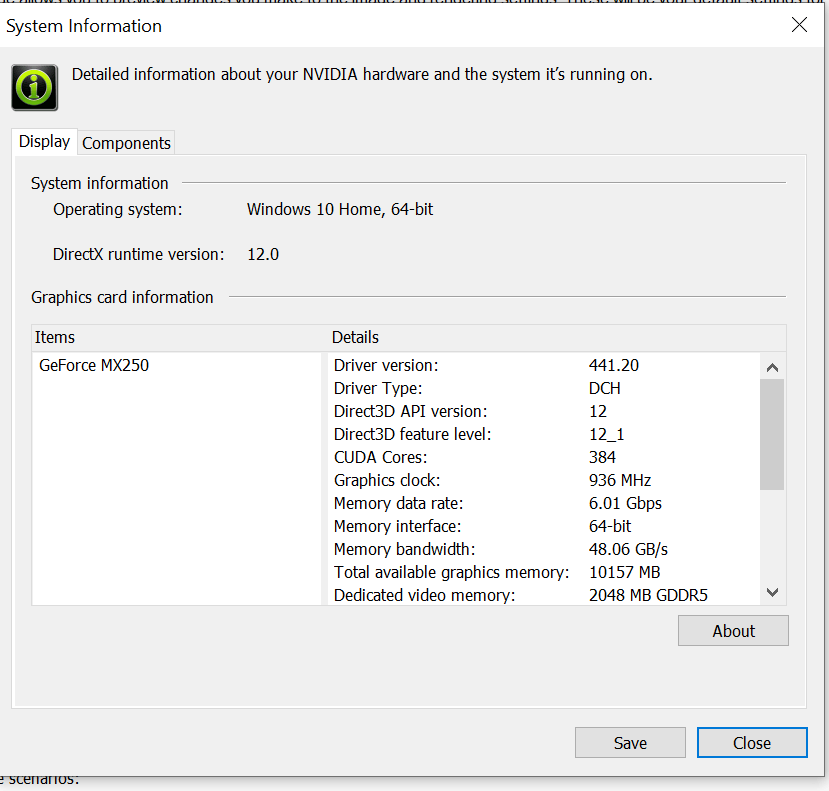

    The graphics card is an NVidia GeForce MX250

    What exactly is your NVIDIA graphics card model?
