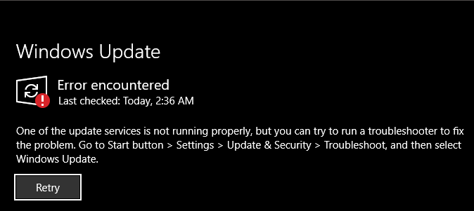

My windows update is not working.
It said: "Error encountered. One of the update services is not running properly, but you can try to run a troubleshooter to fix the problem. Go to Start button > Settings > Update & Security > Troubleshoot, and then select Windows Update."
I've tried running the troubleshooter but it didn't fix the problem.

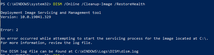

Trying to fix the problem with DISM, also failed due to error 2.

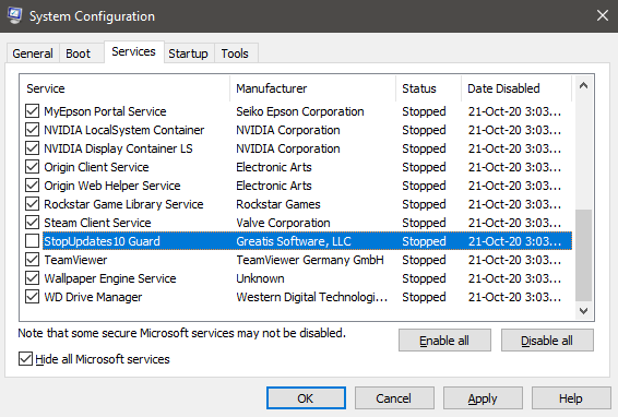

    2020-10-20T20:20:54+00:00
    Hello John,
    I tried the steps you provided and it worked, my Windows can now perform updates.
    However, when I take a look at the services I found this:
    I don't recall installing this software and I'm not sure how it was installed.
    I cannot find the software that runs this service. Googling it suggests that this service is stopping the Windows Update Service.
    Is this something I should be concerned with? Thank you.

    2020-10-21T07:17:44+00:00
    Hello John,
    I have successfuly remove StopUpdates 10 Guard by downloading its installer. It fixed all my problems.
    Thank you for your help! Really appreciate it
