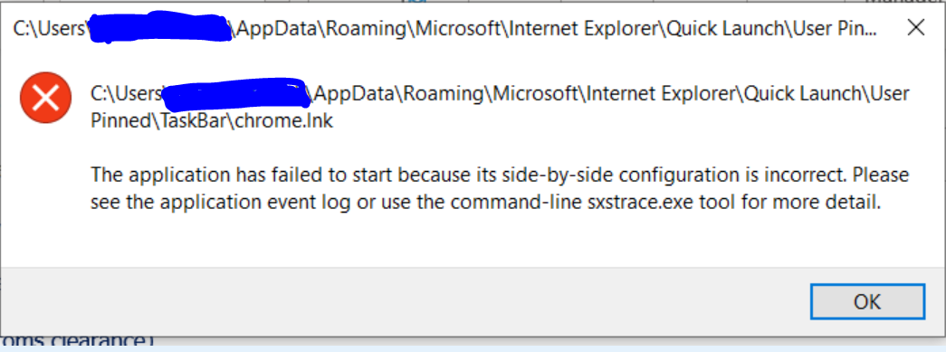

When I try to open google chrome I get the error message "The Application has failed to start because its side to side configuration is incorrect". I have provided the screen shot below. Any suggestions?

    Actually, you are not alone to receive the error and many users have reported this issue. When trying to open a program, Windows will show you the error message:
    “The application has failed to start because its side-by-side configuration is incorrect. Please see the application event log or use the command-line sxstrace.exe tool for more detail.”
    This problem could happen in a number of programs. And one of the most common reasons for this issue is a conflict between the C++ run-time libraries with the app. As a result, the app fails to load the required C++ files due to the conflict. Besides, corrupt system files may also give rise to Windows 10 side-by-side configuration error.
