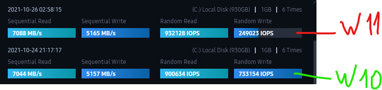

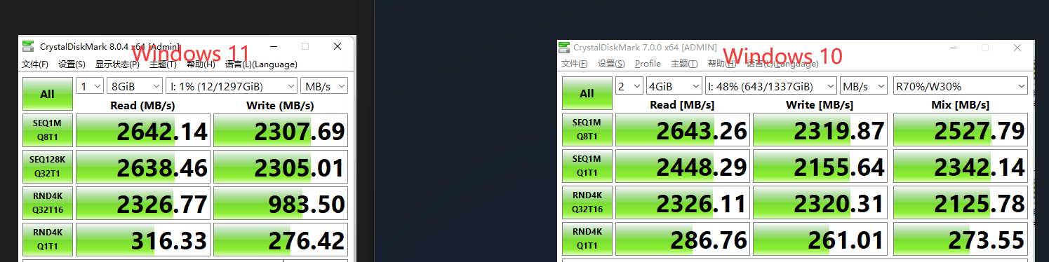

As you see above, the other performance is about the same, but in RND 4K Q32 T16 the speed has dropped significantly. I know that because the two software versions are different and the condition of the computer is different, it is normal for the performance to fluctuate, but this performance also dropped too much, and the performance remained stable low after many tests at different times.

    I have a similar issue with my Samsung 980 Pro, as you can see in the image, read/write sequential is pretty much normal/same as W10, and even random reads, but random writes IOPS tanked to half:
