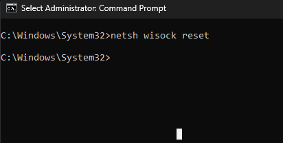

I was having issues with my VPN client not connecting properly. After doing some troubleshooting I went to run netsh winsock reset
(yes, I know I misspelled "winsock" above... regardless the issue remains.

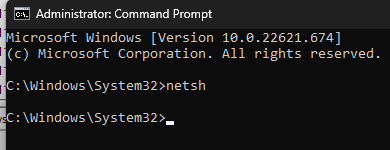

which as you can see did not have the normal response.. after further investigation any netsh command would fail similarly

    I could not run your suggestions as netsh was crashing, hence the netsh winsock reset wouldn't run or work. ipconifg's run, but are irrelevant to the problem.
    Anyway, I ended up rolling back to win 10, then re-updating to win 11 22H1 which seemed to resolve the issue. I believe this is a problem with win 11 22H2 which is what I was on..

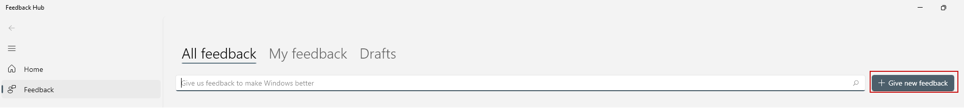

    At the same time,you may file a report in the Feedback Hub app and share your concern about this issue .Your feedbacks will be heard by the Windows team and we will consider improving Windows
    Windows +F to open the System Feedback Center and just create a new feedback.
