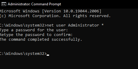

So, I waited for 2 hours and be able to sign in using PIN, then I decided to remove the password using every possible method available online, including running cmd as administrator and executing the command net user Administrator *. I got this output.

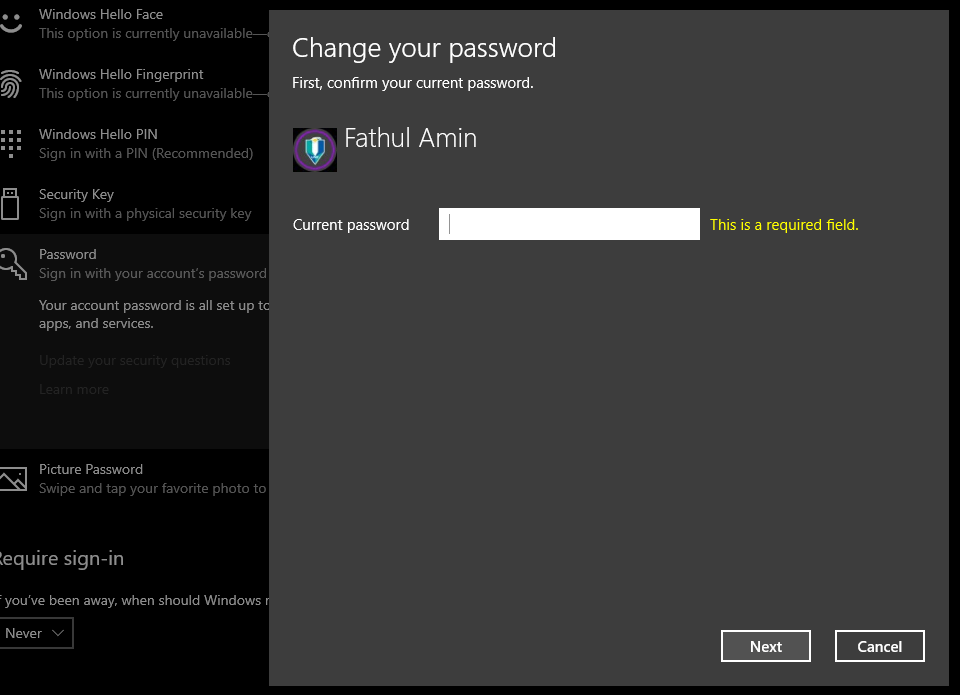

Then I double checked from the Sign In options settings to remove the password, but to no luck, this happens.
It's like the password is still there and not removed, how on earth is this happening? I have admin privilege on local account and remember my PIN but not the password. How to solve this?

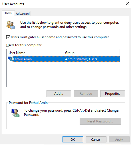

I tried launching netplwiz but the option Reset Password is greyed out.

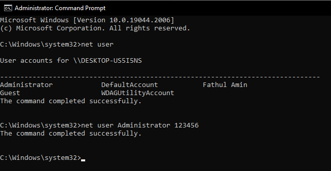

    2022-10-05T09:27:00+00:00
    I have done what you said, and this is output screenshot.

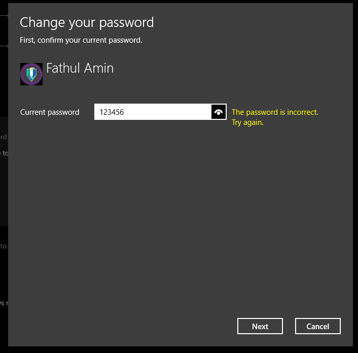

    I have set the password to 123456. Then I try removing the password using the new password, then this happens.
    Can you find a solution for this?

    What you have changed is the administrator account's password .
    if you try to login in with the user name Administrator, the password would be 123456
    use the administrator account to change the password for the account you forgot.
    or enter the following
    net user "Fathul Amin" 123456
    75 people found this answer helpful.
