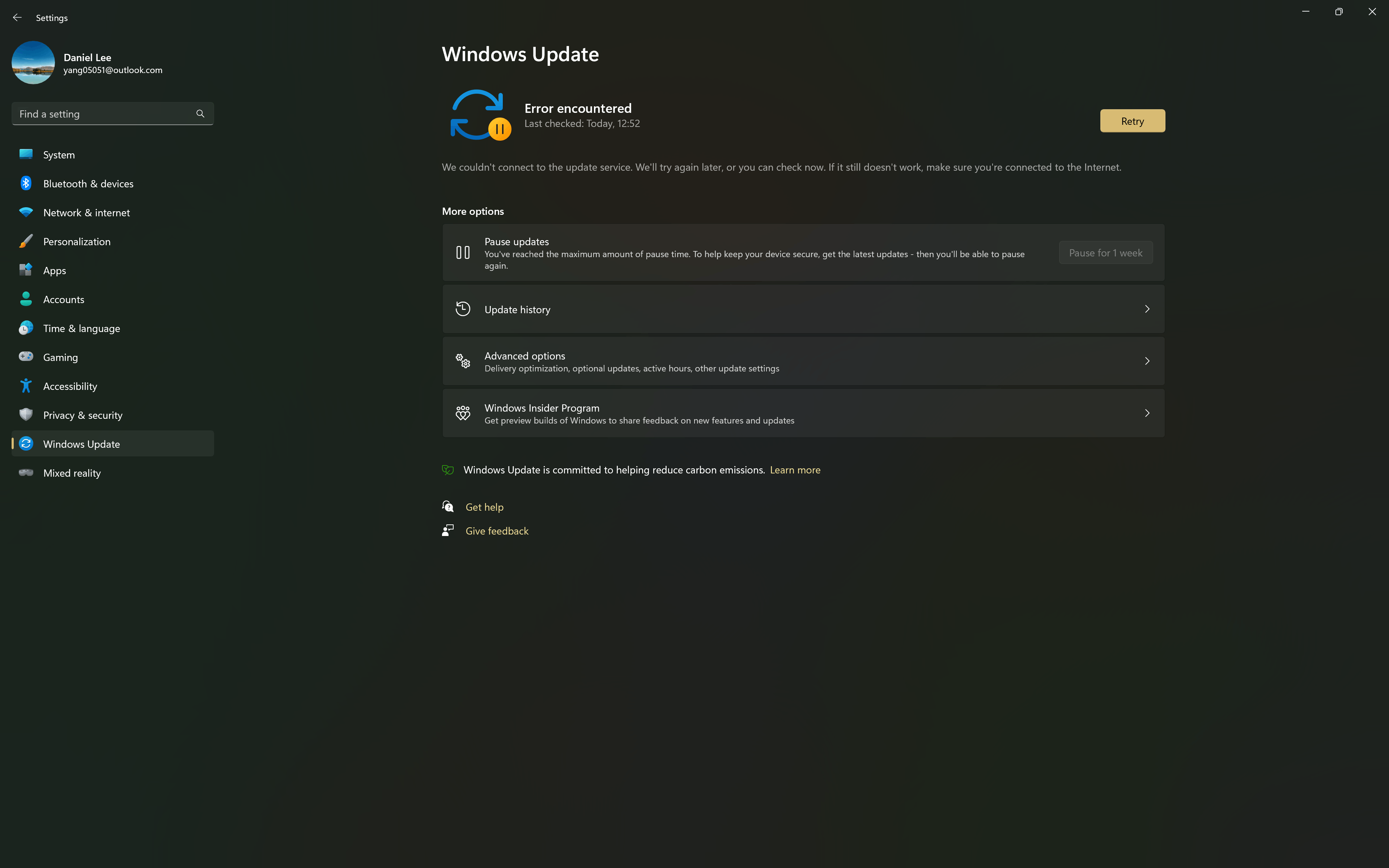

Windows Update: We couldn't connect to the update service. We'll try again later, or you can check now. If it still doesn't work, make sure you're connected to the Internet.
2023-01-30T05:06:19+00:00
Windows Update encountered the issue:

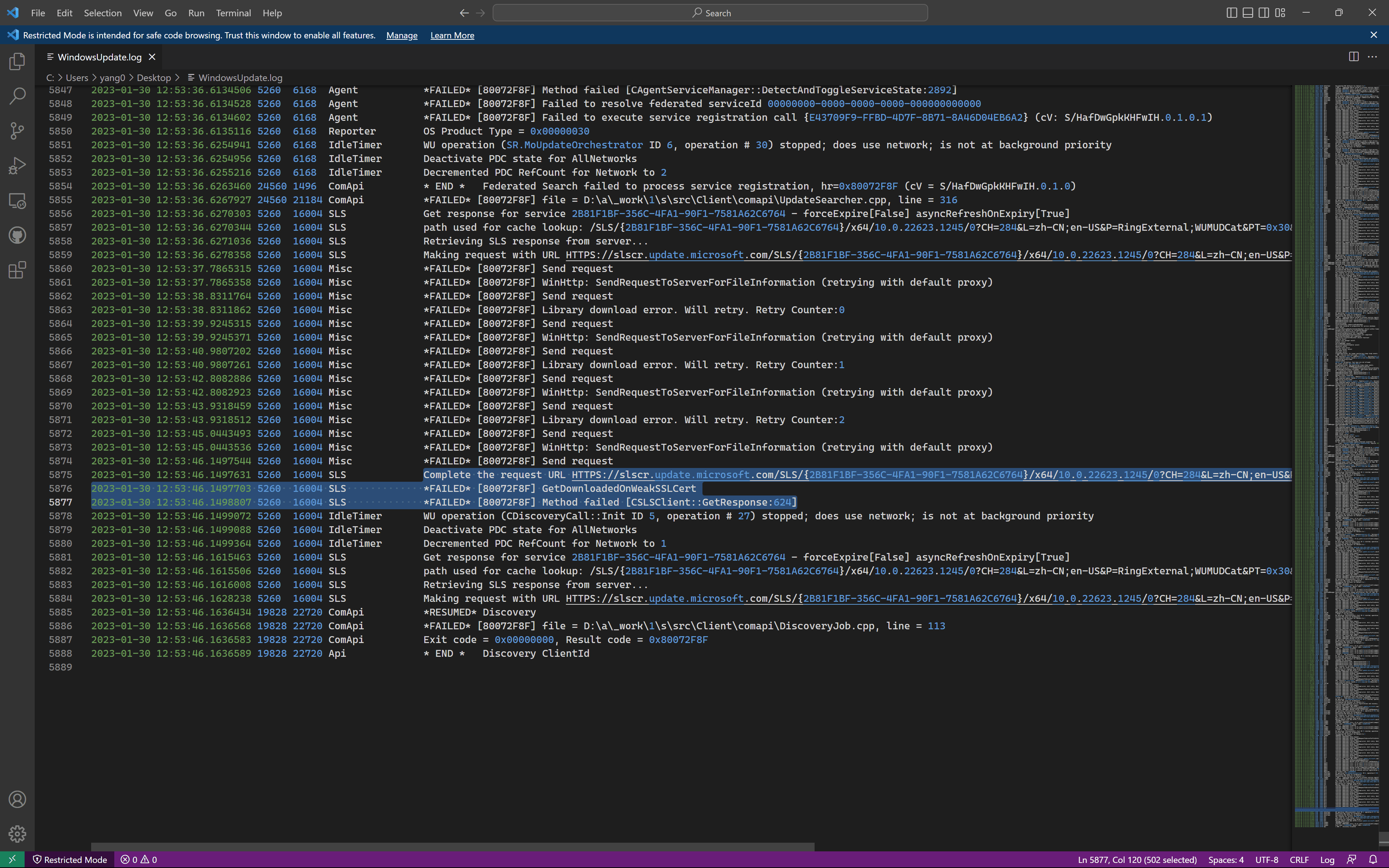

And when I checked the log, I found the following error, as the screenshot shows:
Complete the request URL HTTPS://slscr.update.microsoft.com/SLS/{2B81F1BF-356C-4FA1-90F1-7581A62C6764}/x64/10.0.22623.1245/0?CH=284&L=zh-CN;en-US&P=RingExternal;WUMUDCat&PT=0x30&WUA=1022.1108.2012.0&MK=LENOVO&MD=82TF with [80072F8F] and http status code[0] and send SLS events.
2023-01-30 12:53:46.1497703 5260  16004 SLS             *FAILED* [80072F8F] GetDownloadedOnWeakSSLCert
2023-01-30 12:53:46.1498807 5260  16004 SLS             *FAILED* [80072F8F] Method failed [CSLSClient::GetResponse:624]

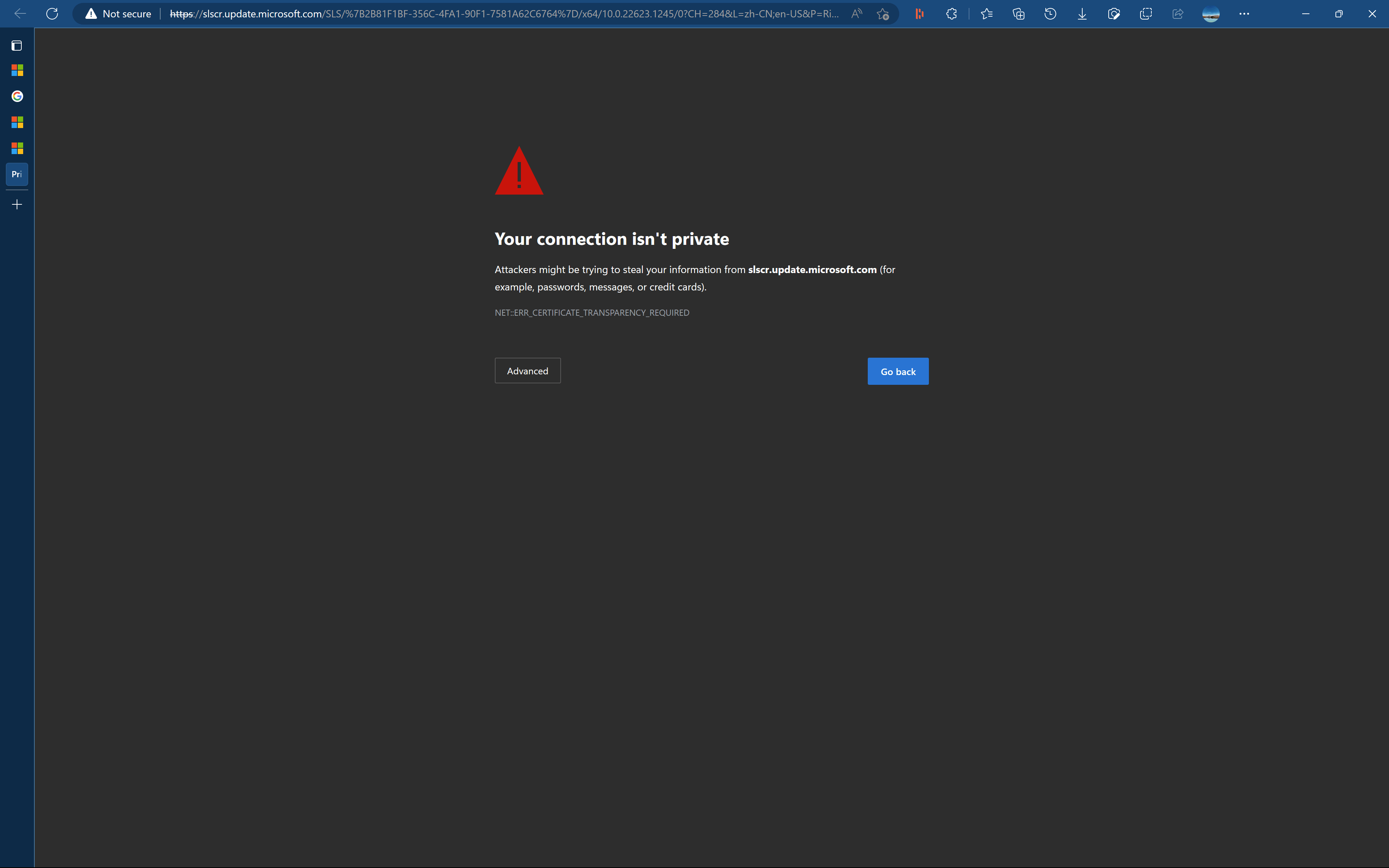

And when I visited the URL Windows Update requested, I got the following error, which stated that the certificate is not trustworthy:
NET::ERR_CERTIFICATE_TRANSPARENCY_REQUIRED
