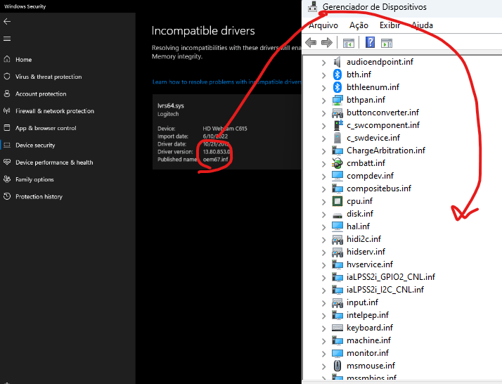

    2023-02-01T18:39:27+00:00
    Follow below a suggestion for remove the driver manually.
    Search the drive and just delete.
    This is the best answer I have seen so far, but to get to this view, go to Device Manager > View (on top) > and click "Devices by driver".
    Then, as described by this user above, remove the drivers based on the "Published name" you saw from the Incompatible drivers list.
    8 people found this answer helpful.
