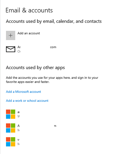

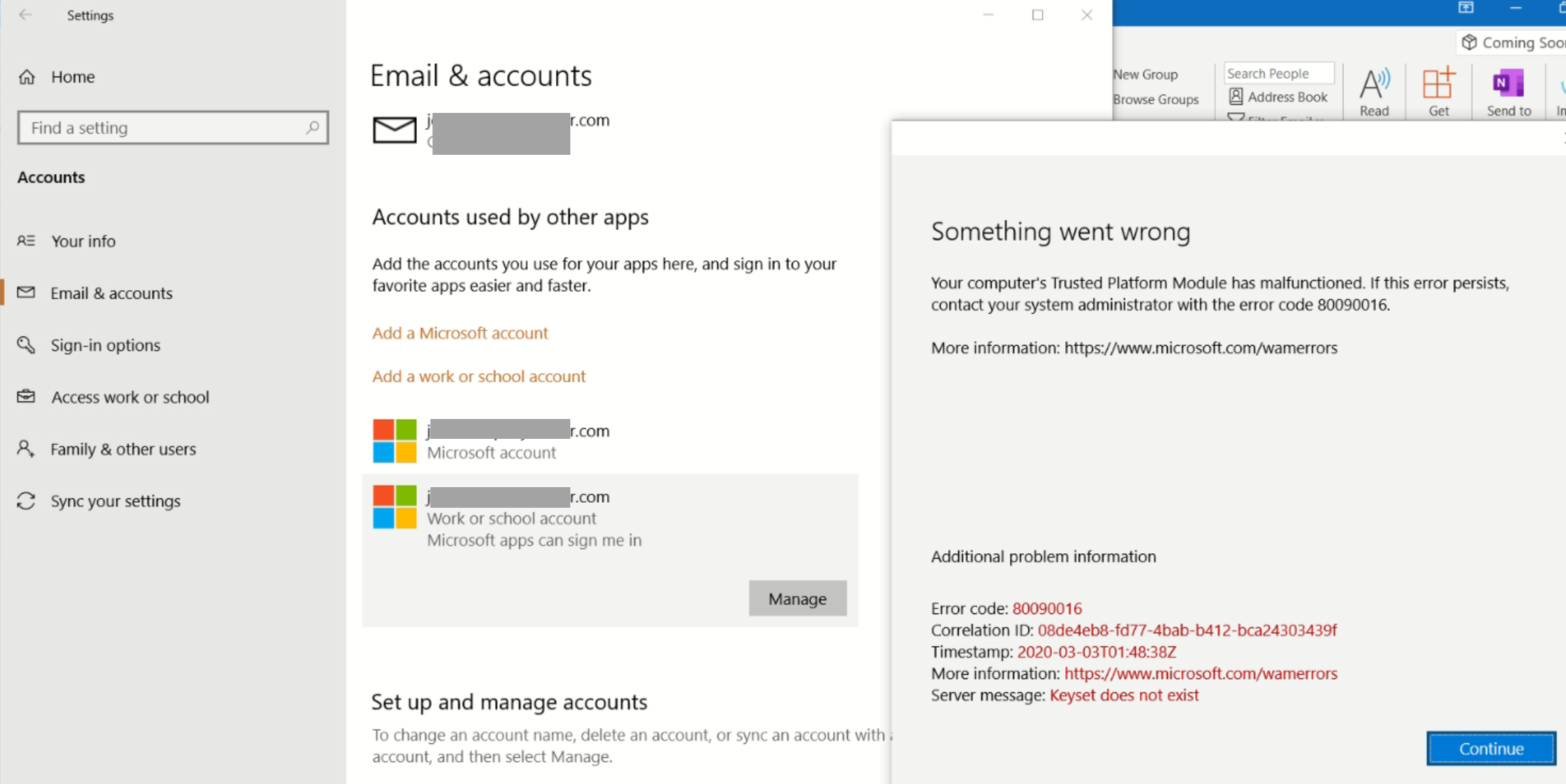

When I try to add a new Office 365 email to my outlook I get the error below.   I think it's because of my "Work or school account" which I want to remove. I'm not sure how my email was signed up for this second account. I set up this computer for home use only, I won't be using any of the Microsoft Azure features.
My question is, what will happen when I remove my “work account” and leave my Microsoft account?  Everything is backed up on Onedrive, I just don’t know what to expect because when I went to remove it, it warned me about losing data and settings.

    Thank you for your description and screenshot.
    Here’s mine:
    I added one free Microsoft personal account to Mail app, and then add 3 Exchange accounts to Outlook desktop app. Therefore, from your screenshot, I think that the above one is the account you added to Mail app, the bottom 2 are that you added to Outlook app. Please feel free to correct me if I misunderstood anything.

    From the error literally, it’s related to Windows OS Trusted Platform Module, you can check whether TMP works correctly via clear TPM (please note that it will reset security processor to back to default settings): https://support.microsoft.com/en-us/help/4096339/windows-10-device-protection-in-windows-defender-security-center#clearTPM. You may then also try to turn TPM off via: Press Windows Key + R to open the Run window -> type tpm.msc in the box and press Enter -> Click the Action panel, select Turn TPM Off (if there's this option) -> after done, restart Windows to test issue again. You can later turn it on.

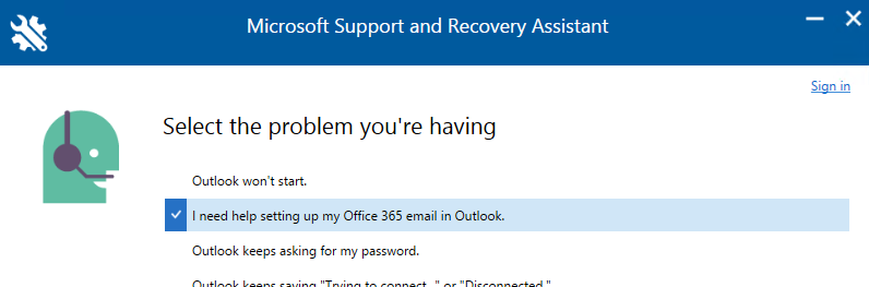

    Besides, for Outlook, you can use Office 365 SaRA tool to fix the issue: About the Microsoft Support and Recovery Assistant.
    If the option (I need help setting up my Office 365 email in Outlook) doesn’t work, try to perform inspection by following this article: How to scan Outlook by using the Microsoft Support and Recovery Assistant.

    I had the same 80090016 etc. issue.  I followed the solution below. Deleting the Contents of Ngc Folder didn't do it.  I wasn't able to rename the "C:\users$dir\AppData\Local\Packages\Microsoft.AAD.BrokerPlugin_cw5n1h2txyewy" folder, but I deleted everything in it that I had permission to.  Then I was able to sign in and add my account to the desktop version. I was also able to activate my Office 365 ProPlus after this too.

    Thank you for your reply. Unfortunately, it didn't work.  I used the recovery assistant and it created a new outlook profile. I wanted another Office 365 email added with my other 2. With the new profile, it creates a lot of extra steps to check that email.  When I tried to manually add the email again, I got the same error.
