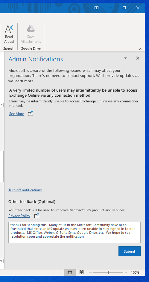

    sorry for the delay in my reply.  thanks for your message.  This is very frustrating.  I received a message on MS Outlook today I wanted to share with you. I believe it is related to our collective issues and it may appear MS is aware and working on a solution. Attached (below my closing signature) is the screen shot I took of my Outlook Admin message.  HTH.
    Please let me know if you hear or see anything out there. I have decided not to re-do a user profile or anything else.  The issues only arise when I reboot my laptop.  Then once rebvoot is complete I have to sign in to all my apps and services.  The only thing that is giving me issues is signing in to Office 365 apps.  This won't work at all.  I get the triangle next to my name on each office product.  Otherwise my services and apps stay logged in.
