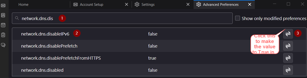

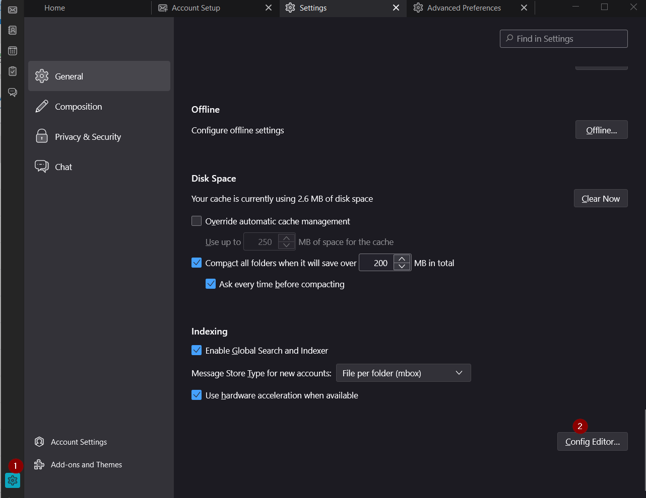

    Also under Thunderbird --> Click on the gear icon on the bottom left bar --> General --> Config Editor --> Show All
    Type network.dns.dis in the search field
    Select the very first option and click on the toggle arrow on the right, make it true
    Close and reopen Thunderbird.. See if this helps
    Let me know how it goes

    2022-12-28T21:34:14+00:00
    Yes, it is worked for me too!
    I just disabled ipv6 netwotking in thunderbird advanced configuration editor (network.dns.disableIPv6 = true)
    and it is works again like a charm!
    131 people found this answer helpful.
