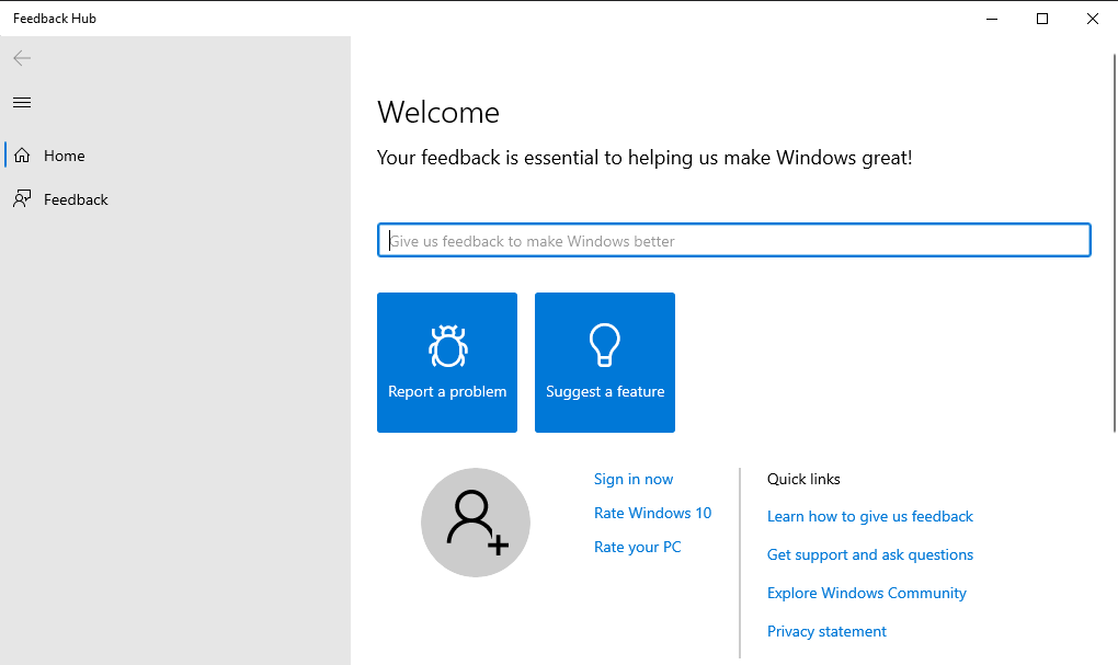

    If all above could not resolve, we suggest that you can report the issue to Feedback Hub so that the developing engineers can check it.
