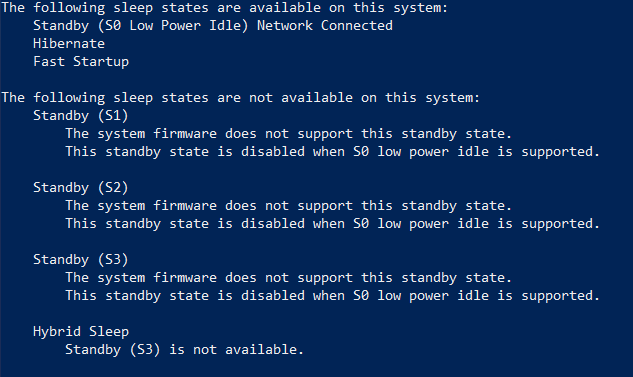

Dell Laptop 5515 (AMD) with brand new Windows 10 Install. Note this laptop has "Standby (S0 Low Power Idle) Network Connected"

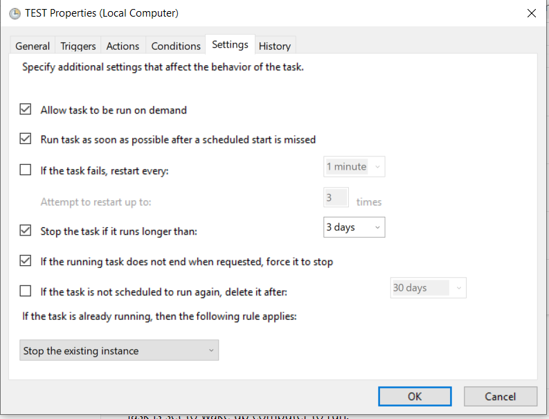

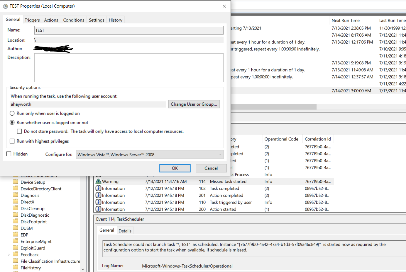

  • Created a new simple task but computer does not wake up at predetermined time to run.
  • I can see this on several tasks but I need this to work for a Windows Server Essentials backup (which also fails)
  • Task will run if task flag is set to run the task as soon as possible once computer lid is opened.
  • Task is set to wake up computer to run.
Laptop is set to sleep after x minutes but S0 is obviously working in the background when looing at event logs!

    3."Note this laptop has "Standby (S0 Low Power Idle) Network Connected"
    How can set my laptop to this mode"Standby (S0 Low Power Idle) Network Connected"?
    4.If create temp folder in c disk on issue PC and run powercfg.exe /SleepStudy in CMD, Is there anything related to our issue?

    .I think server essentials client backup support sleep or hibernate mode to back it up but I not sure it support "Standby (S0 Low Power Idle) Network Connected" mode. So we have "Task will run if task flag is set to run the task as soon as possible once computer lid is opened." this symptom.

    The temporary task I created above does not wake up at required time nor does the server 2012 Essentials client backup task.

    Will try and upload power report but I don't see anything unusual.

    .I think server essentials client backup support sleep or hibernate mode to back it up but I not sure it support "Standby (S0 Low Power Idle) Network Connected" mode. So we have "Task will run if task flag is set to run the task as soon as possible once computer lid is opened." this symptom. Yes i did do this but obviously Id like the backup to occur during the off hours ie during the night.

    Above articles don't really help for S0 power state
