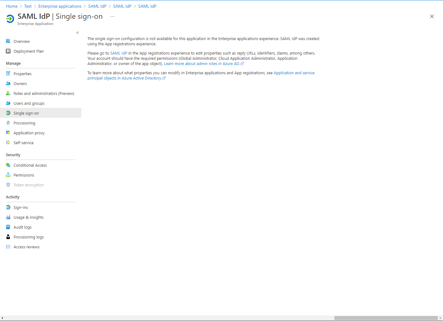

Greetings. I am trying to set up my Azure AD as a SAML IdP without luck. I created a custom app and tried to navigate to the Single Sign-On tab mentioned in this tutorial https://learn.microsoft.com/en-us/azure/active-directory/manage-apps/add-application-portal-setup-sso, but what I got was the following screen:

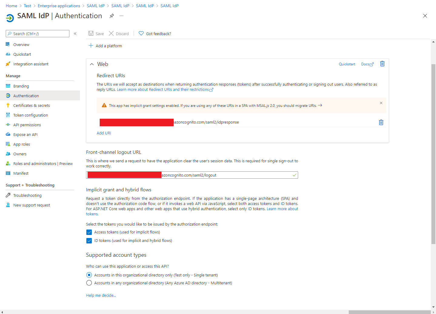

Attempting to follow the instructions on the page, I provided the SP signing certificate, SP ACS endpoint as a redirect URL, SP SLS endpoint as the front-channel logout URL, and enabled Access tokens and ID tokens in the Implicit grant and hybrid flows as the following screenshot:
but still without luck, navigating to the "Single Sign-On" screen still shows the same instructions. Could someone point me out what I have missed?

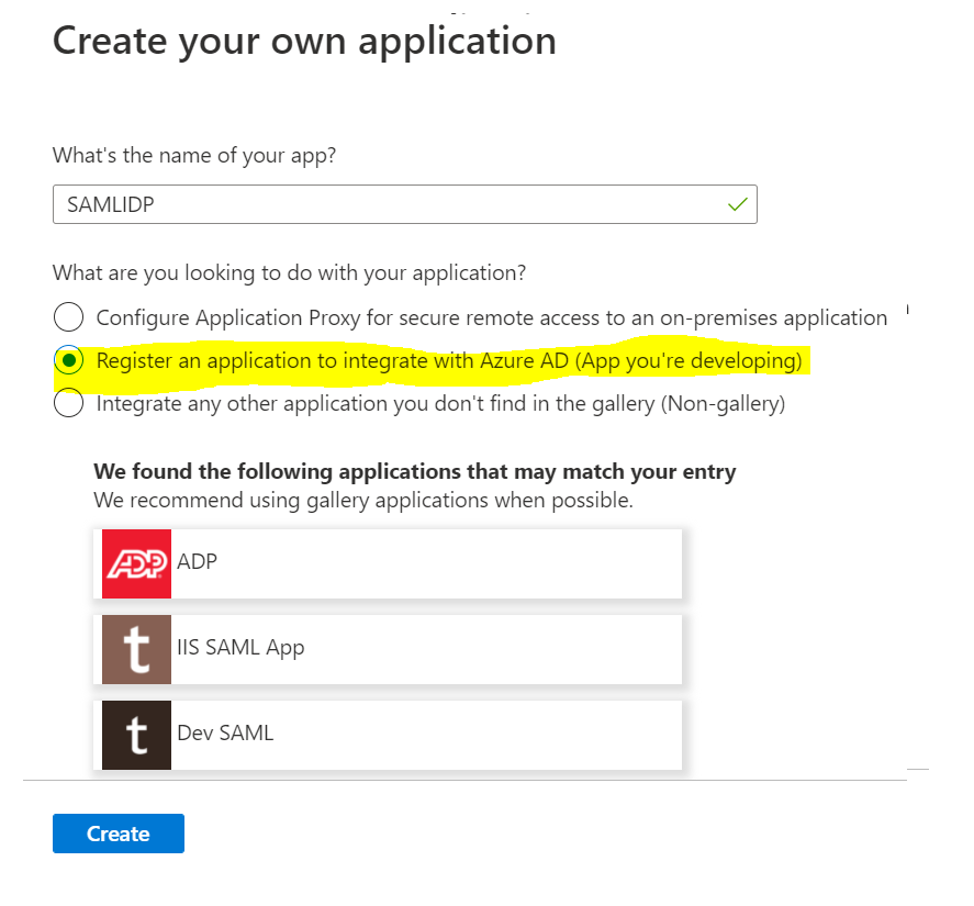

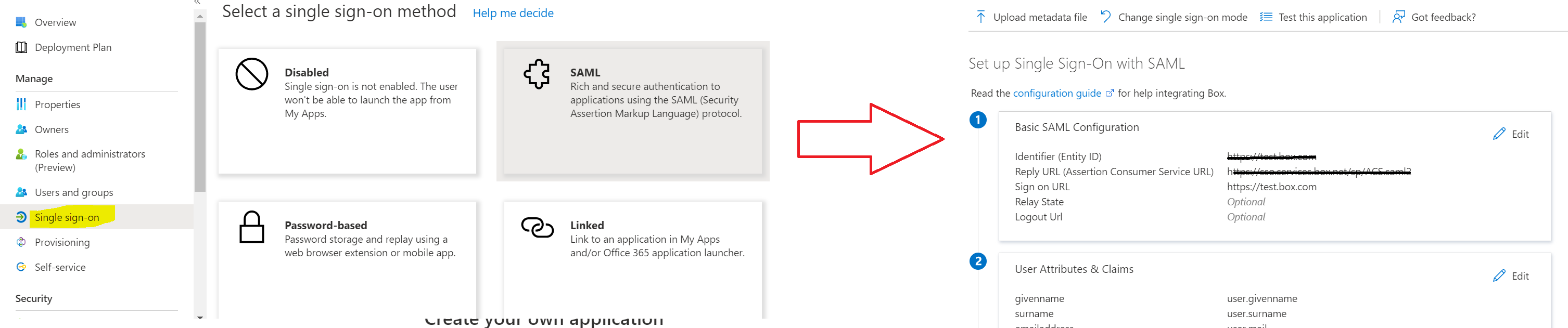

    Could you please try creating application from "Enterprise applications blade" by selecting third option ( which is Integrate any other application you don't find in the gallery (Non-gallery) ) as shown below and you would find SAML SSO settings.
    Application creation:
    SSO setting once App created
    Because, if you create application either from "Apps Registrations" blade or selecting below option from "Enterprise applications balde" then above error is expected.
