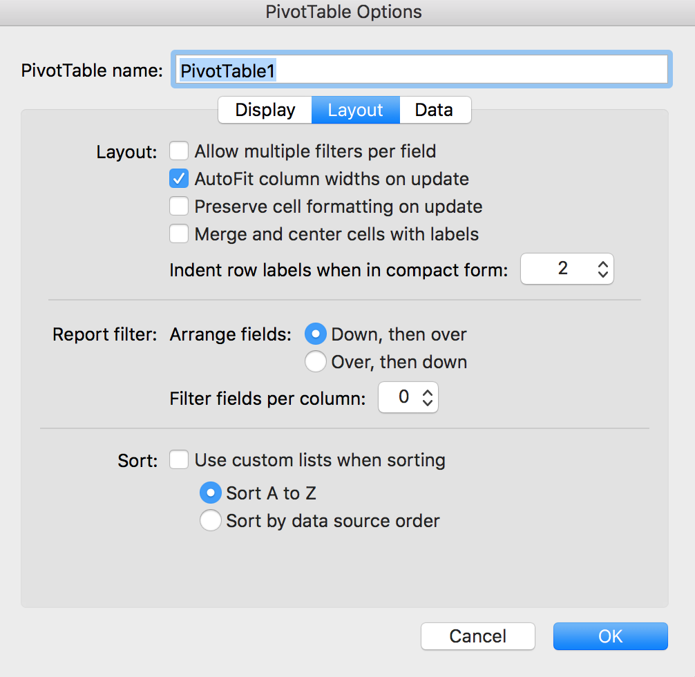

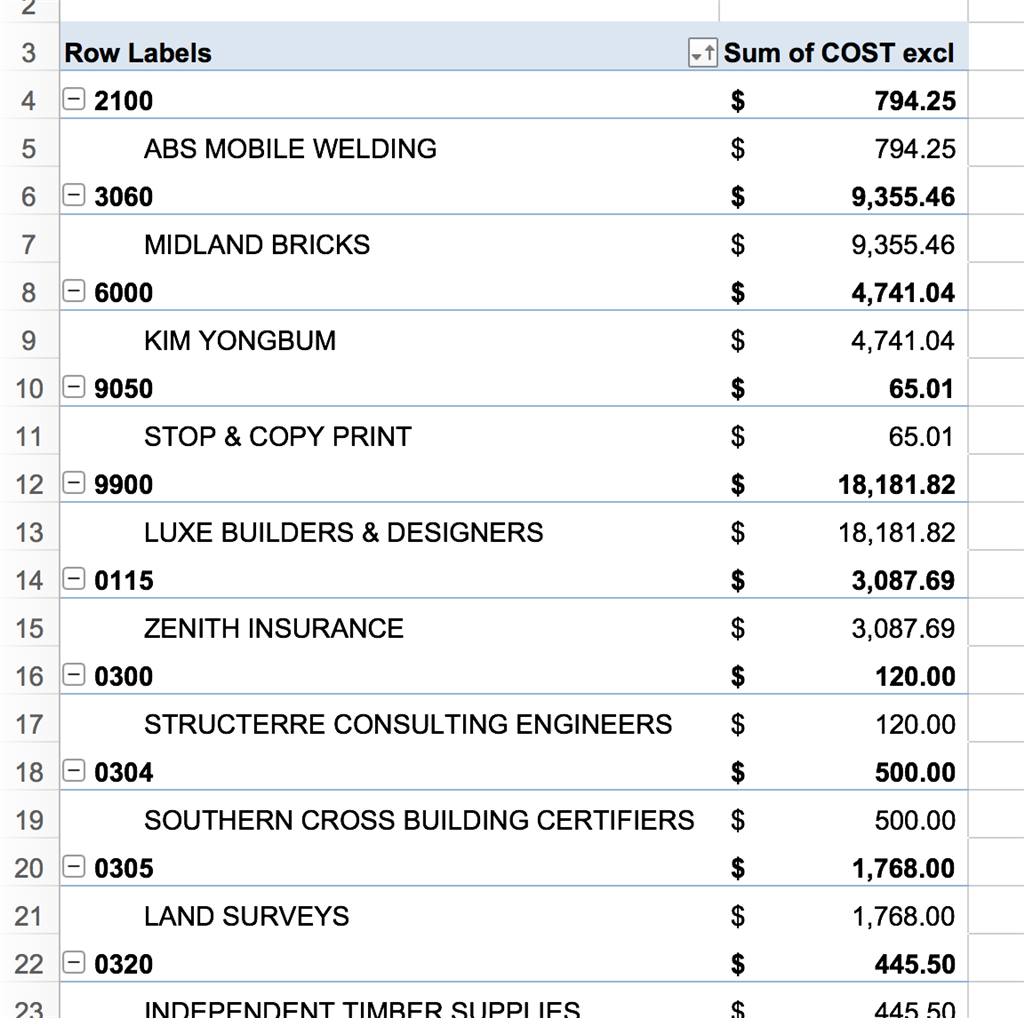

Why when I select to Filter a column of Numbers into Ascending Order the numbers don't change? I've noticed that if I amend the data source then on the pivot table the modified number "climbs" to the top of the list and still can't filter into ascending order?
In pivot table options - Layout (tab) down the bottom there are "Sort" options which I have also played around with and still doesn't change what I am trying to do.

    Jim,
    I've selected the A column and changed format to "Text". I have click the on filter on column A to "Ascending" with NO response ???

    2016-05-04T00:56:19+00:00
    You can see that the Cost Centers beginning with "0" will not filter to top of the list ???
    Above is the Settings for this pivot table, thinking that the "Sort" option here would override Field filter settings but it doesn't do anything or change the filter order....

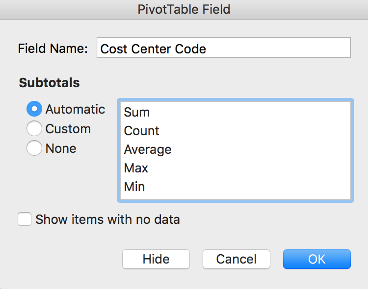

    Above is the Field Settings for "Cost Centre Code"...
    Hopefully this gives enough information for you to help ???
