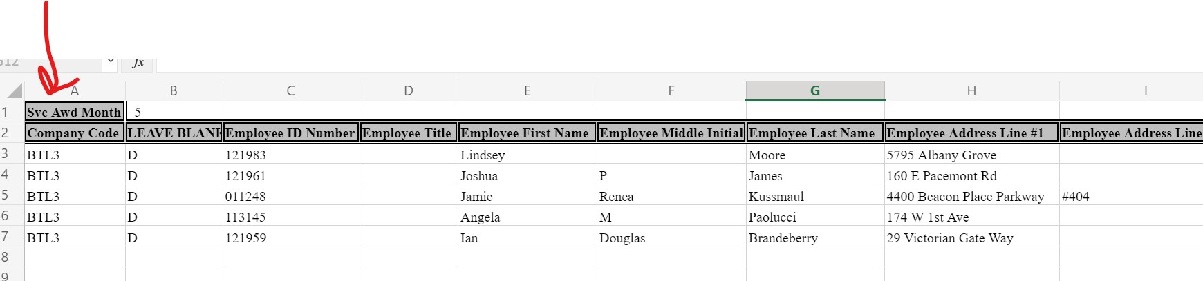

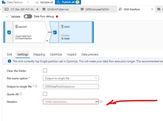

I have a question. I need to add a header to a csv file (a header above the column headers). Can someone tell me what goes in the headers box shown below? Is this for a header like I am needing? I have googled and found nothing on this headers box.
Thanks
Mike
This is what I am trying to figure out how to do with Mapping Data FLows:

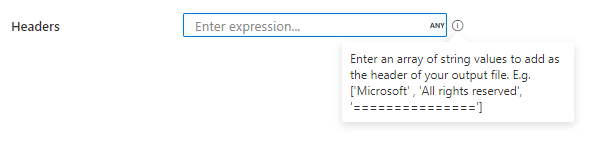

  1. MarkKromer-MSFT 5,226 Reputation points Microsoft Employee Moderator
    2021-07-27T18:43:52.403+00:00
    Hover on the info bubble next to the Headers field to get a tooltip. That Headers field will add lines at the top of your output file that are unrelated to the column headers.
