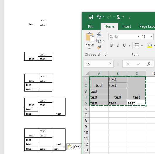

Windows 10, Office 2016 Pro Plus both fully patched.  Have a word document that includes multiple tables, in each table there are merged cells.  If the cell is merged you can't click on the cell or see the data in the cell.  If you copy the table out of word and paste it into excel the data shows.  If you un-merge the cells and paste it back into word it shows all of the data.  I tried this on a system that is not patched and the merged tables display properly in word.  Why would an Office update break pasting merged cells into a word document?  Any advise on this will be greatly appreciated, this is impacting over 4600 documents at this time and I am sure we will be finding many more.  Here is a screen shot of a sample table and what word is doing with it.  You can't click in the blank cells once it is in word.  Thanks all

    I did the repair and it seems to have made the issue better but still not working properly.  Our existing document had no change.  I made a test excel sheet with multiple merged cells and pasted into word, still not displaying the text in all of the merged cells.  Thanks for the help.
