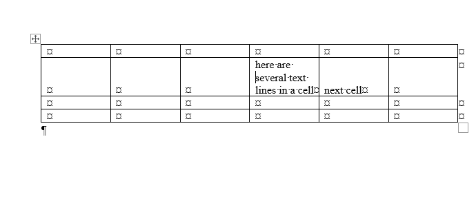

    The "Bottom" value on the Cell tab of the Table Properties dialog box aligns cell contents to the bottom of the cell. If the cell contains blank paragraphs, changing the cell alignment won't make a difference.
    Click the ¶ icon on the Home tab to display all nonprinting marks.
    Here is what I see after changing the cell alignment to "Bottom" for all cells:
    In the above example, all table rows have a variable height.

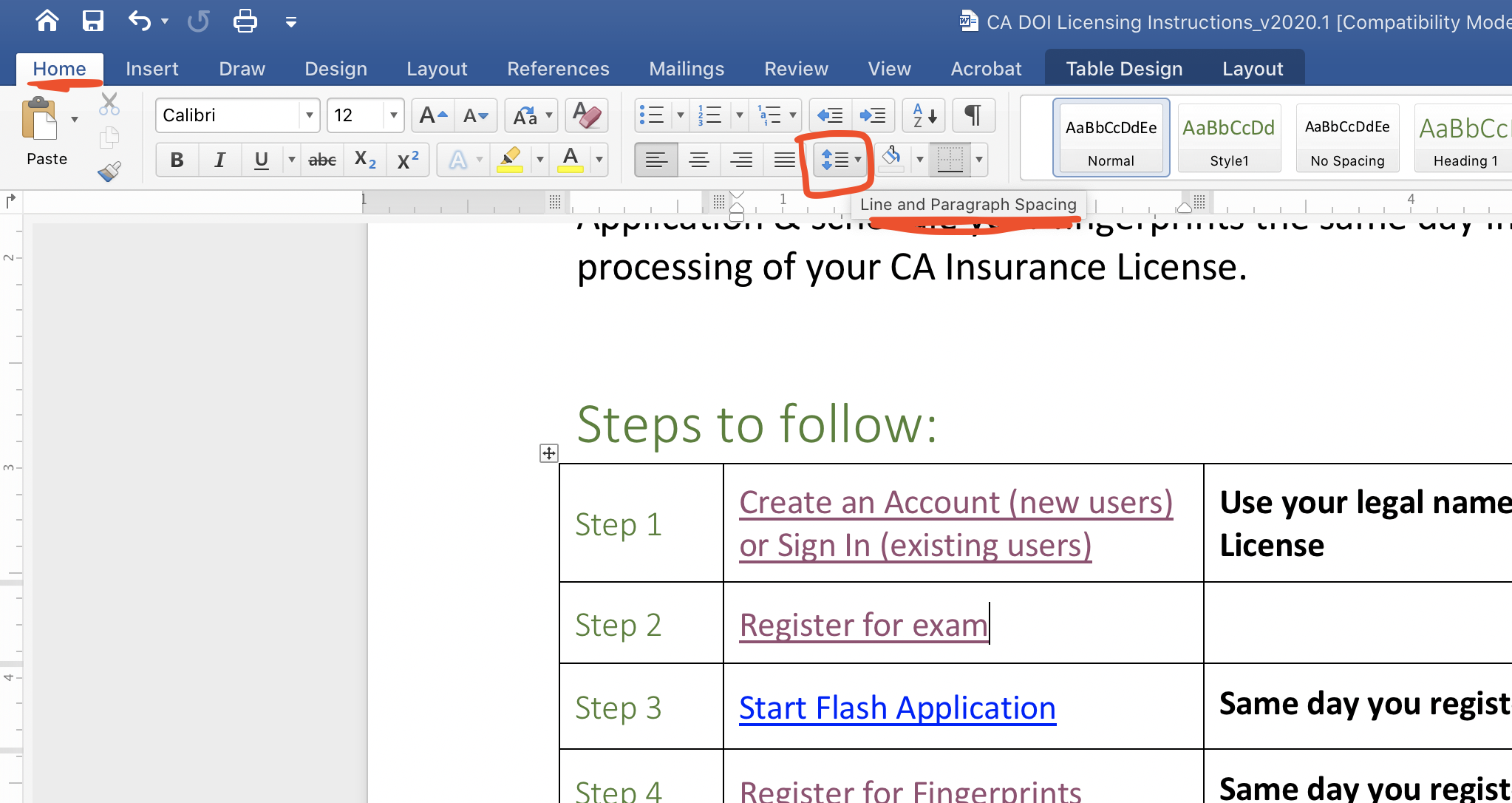

    2020-01-07T22:55:55+00:00
    See arrow above for what I'm trying to do.
    This should be one way to do it.
    This should be another way to do it.

    2020-03-23T18:45:40+00:00
    I was having the same problem. I had to first change my line spacing to auto or 0, before alignment feature would work.
