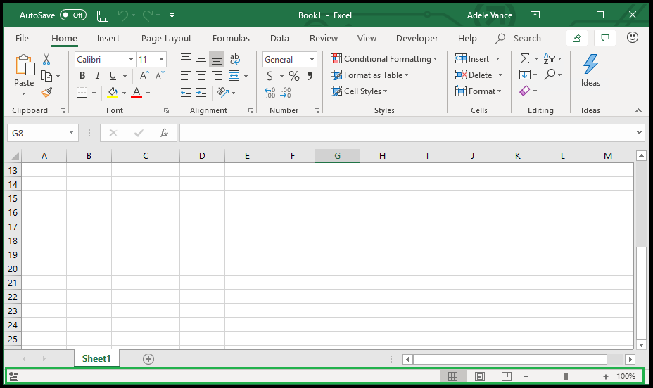

    2019-07-30T18:31:38+00:00
    In Skarl's picture it shows what is missing but not that it is missing.  I have highlighted the same area in my picture and there is no status bar.  I can click on the little arrow down there by "Help to Improve Office" and customize the status bar, but there is no way to view it.
    20+ people found this answer helpful.
