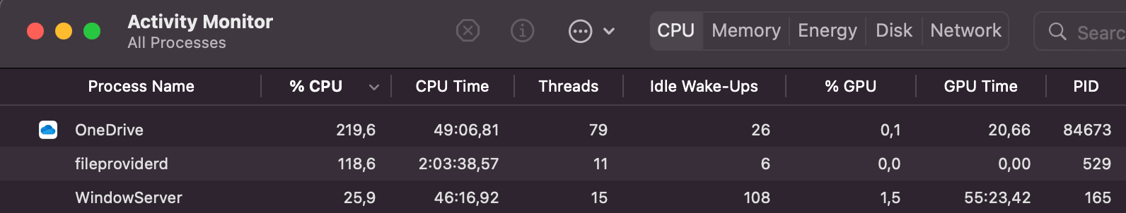

After updating to 22.012.0117.0003 CPU utilisation became very high, and OneDrive keeps syncing, even when there is no new file.
It takes up to 200%, and causes fans to spin loud, and battery drain.

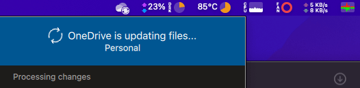

    I reset as suggested; after setup, OneDrive spent some time accessing files on the disk and the network for a while, and then it keeps "Processing Changes" keeping my CPU at >200%, fan spin to max and battery drains. But there is no application reading / writing data.
