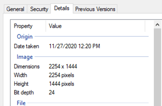

    And we have also tested it on our side with the latest version of Word Current Channel 2112 Build 14729.20260, and the original resolution of the image is 2254*1444, as shown below:
    Then we inserted the picture into Word, then set the resolution as 220 ppi as same as yours, then we saved the picture to the local from Word, and it shows the 623*399, as shown below:

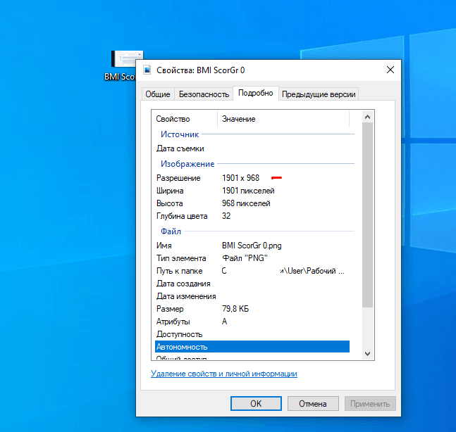

    1. All images. For example I create a new docx file and add here (drag a drop) picture (png) with resolution 1901*968.
      This will automatically fit to the width of the page.

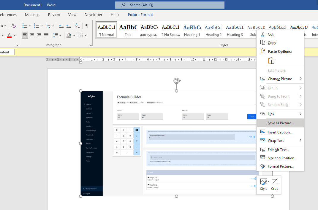

      After that I press right button 'Save as Pciture'... And it saves it to disk with resolution 645*328. As I understand it, with the resolution as it is presented on the word page in App.
      If I resize the picture on page (it looks good on page as it is) and repeat 'Save as Picture'.. It saves it with changed resolution (e.g.1082*550) but not original 1901*968.
      In previous version it would be saved in original resolution
