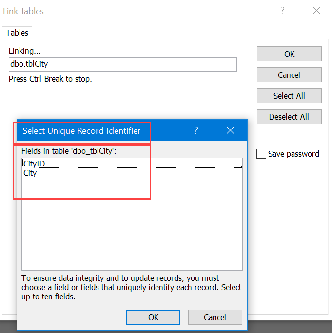

    You have an Oracle database, which I haven't used for a long time and don't recall specifically. So this may or may not be useful. When you initially link to the tables in the Oracle database, do you see a dialog like this? It appears when Access can't determine the Primary Key. In this case, CityID WOULD be the PK, but it's not designated as such. Perhaps you need to select the field or combination fields that make up the PK in these tables.
    The set up for Oracle may be different, but look for a similar feature.
    2022-02-02T00:17:40+00:00
    Only one of the tables prompts me to define the primary keys, the rest are automatically getting that defined as they are linked. I've checked through the tables in Design View and I can see the appropriate primary key is being defined by Access, so I don't think it is losing that information as we're pulling it into Access.
