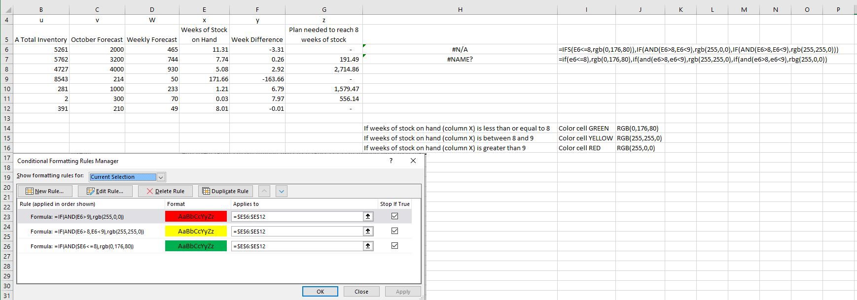

Hello - I'm trying to use the formulas below to color a column of cells that contains a formula but it's not working:
If the results of the formula in Column E is less than or equal to 8 - I want the cell to be Green (RGB 0,176,80)
If the results of the formula in Column E is between 8 and 9 - I want the cell to be Yellow (RGB 255,255,0)
If the results of the formula in Column E is greater than 9 - I want the cell to be Red (RGB (255,0,0)

    You shouldn't include RGB in the formulas, it is not an Excel function. Actually you don't need to use rules of type formula at all.
    Select E6:E12
    Set the fill color to green. This will be the default.
    Click Conditional Formatting > Manage Rules...
    Delete the existing rules.
    Click New Rule...
    Select 'Format only cells that contain'.
    Leave the first drop down set to 'Cell Value'.
    Select 'greater than' from the second dropdown.
    Enter 8 in the box next to it.
    Click Format...
    Activate the Fill tab.
    Select yellow.
    Click OK, then click OK again.
    Repeat these steps,, but with 9 in the box and red as fill color.
    Finally, close the Conditional Formatting Rules Manager by clicking OK.

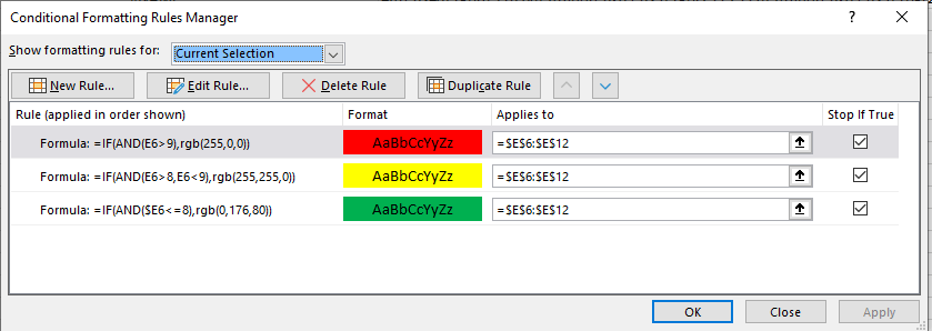

    Hi DeeCee. I am an Excel user like you.
    Everything that I have learned about Conditional Formatting formulas is that the formula must have either a TRUE or FALSE result. In your first formula if the logical test, E6>9 is met, then the result of the formula is "rgb(255,0,0)"--not TRUE, so the conditional formatting is not activated. The AND function is superfluous but not a problem if you want to see consistency within the formulas. Use:
    =IF(AND(E6>9),TRUE)
    Then use the format button to choose the red color. Of course, the other two formulas must also, in the same manner, produce a TRUE or FALSE result.
    On your second formula, the logical test has an issue unless you are going to have decimals. A whole number cannot be both >8 and <9. That logical test will only identify 8.1-8.9.
    Reply if you have additional questions or information. Please mark this reply as answered if this solves your question.
    Rich~M
    2022-09-30T21:22:23+00:00
    Worked like a charm - thank you so much! I even added another rule for cells that are blank - whose formula would return a zero but this spreadsheet must be set to not show zeros for formulas. I appreciate the help - have a good weekend!
