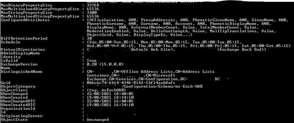

    When I ran the command get-offlineaddressbook | fl Name,guid , the guid of my address book came up with no issues. I can also see the address book listed under the C:\ directory
    I am attaching screenshots of command Get-OfflineAddressBook | fl

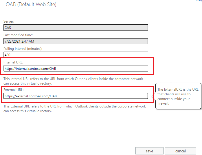

    1. Please run Test E-mail Autoconfiguration via affected Outlook clients and check if the OAB url is returned under the "Results" tag:
      By default it would be the internal or external url of the OAB virual directory, plus the OAB guid.
      OAB virtual directory in EAC:
      OAB guid in EMS:

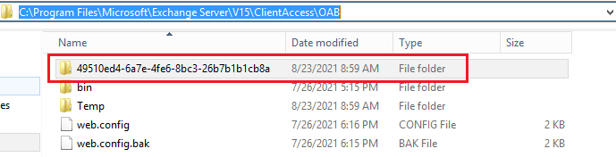

    2.If the OAB url is returned correctly and the url settings are correct on your Exchange server, please check the following path on your server and see if the OAB folder exists.
    Path: C:\Program Files\Microsoft\Exchange Server\V15\ClientAccess\OAB\<guid>
    If the folder doesn't exist, please run the following command to force OAB generation:
    Get-OfflineAddressBook | Update-OfflineAddressBook
    After the folder is generated, please retry downloading OAB in Outlook.
    3.If the issue persists, please run the following command and post a screenshot or post in text of the results.
    (Don't forget to hide your personal information for security)

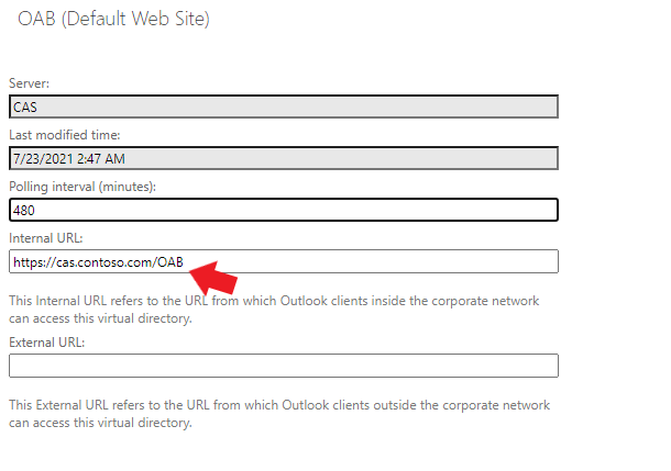

    I checked EAC and found out that the OAB URL's had lots of garbage written! I fixed both the external and internal URL's, gave Exchange a restart + did Recycle but problem still persists. Any idea what I can try next please? Thanks
