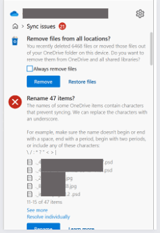

  1. Is OneDrive able to sync .psd files this user had issues of not being able to upload files as the filename wasn't accepted
and and so was the filetype according to the error message in OneDrive [white cross red circle]
  1. I faced the same issue with .jpg files "the file name or type is not supported" despite changing the name of the .jpg file from ._filename to filename, the error still wasn't resolved [white cross red circle]

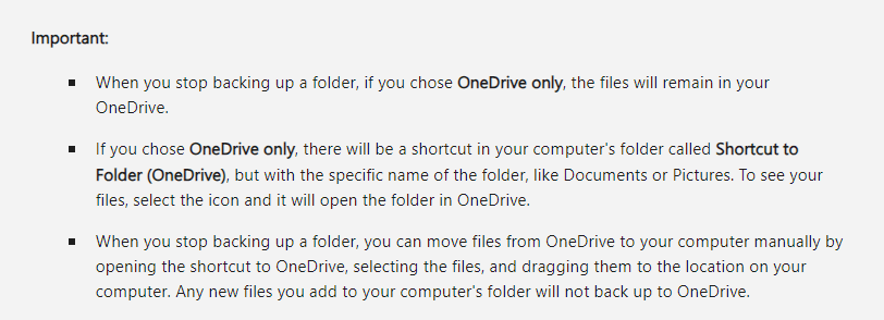

  4. If a user backs up their local PC files [Documents, Pictures, Desktop] and they stop backup will they lose any data?

    1. Regarding the first & second request, of the image of the psd and jpg file, kindly find the screenshot of the psd file [i have removed the file name due to privacy concerns]. The image is a little blurry but the filename starts with ._filename

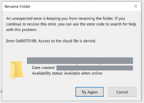

    6. The user tried to rename a OneDrive folder and received error 0x8007018B. As per the following post How to solve error code 0x8007018b I saw, I reset the users OneDrive despite the sync errors that were present [file name/type as mentioned in the original post]. I would just like to confirm if resetting the users OneDrive would delete any files/folders from either the users OneDrive desktop/online. Going forward, would it be better to only reset OneDrive if all sync errors has been resolved or would it be alright to reset OneDrive if some sync errors are present. Attached below is the error message that popped up when the user tried to rename a folder
    Below is the screenshot of the errors that the user had when I reset their OneDrive

    As far as I know, OneDrive supports syncing .psd files. could you please share screenshots of the complete file name of the psd file and jpg file?

    For the question 5, they won't lose data when they stop backup local PC files [Documents, Pictures, Desktop]. When you stop backup, you can choose to save files in OneDrive Only or save on computer only. Here is a support article for reference: Back up your folders with OneDrive - Microsoft Support
