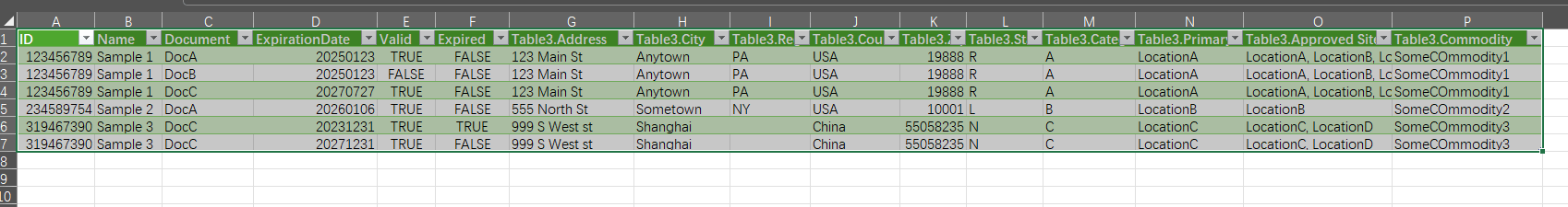

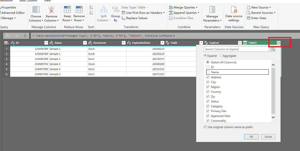

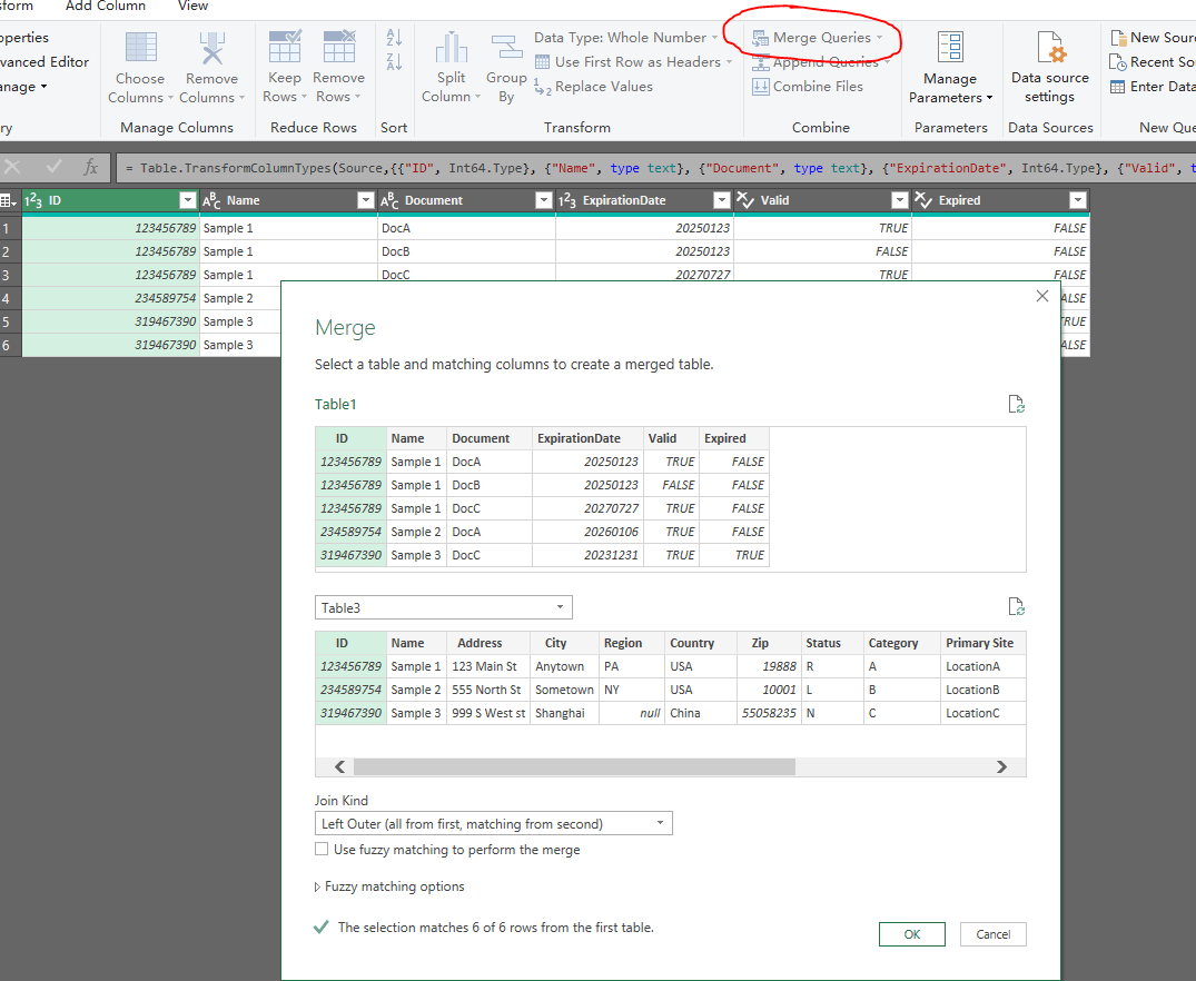

    You may try merge query.
    Result:
