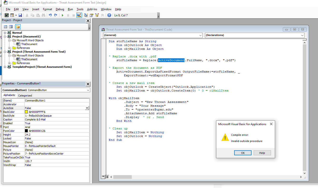

getting another error can anyone help please.

  1. HansV 462.4K Reputation points MVP Volunteer Moderator
    2024-02-26T16:10:10+00:00
    Your code ends with End Sub, but the corresponding line
    Sub macroname()
    at the beginning is missing.
  2. HansV 462.4K Reputation points MVP Volunteer Moderator
    2024-02-26T16:11:47+00:00
    Based on your previous topic, insert the line
    Private Sub CommandButton1_Click()
    at the top of the code.

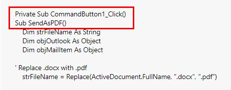

  4. Jay Freedman 205.8K Reputation points Volunteer Moderator
    2024-02-26T17:33:00+00:00
    Looking at this snippet from the previous thread,
    you need one of the two lines in the box, but not both. If you restore the first line, the macro will run when you click the button named CommandButton1 (assuming this code is in a userform that contains such a button). If you restore the second line, the macro will run only when you manually choose to start it (assuming that you have a shortcut or QAT button assigned to it, or use the Alt+F8 "Macros" dialog).
    Also, if you type either line into the macro editor, VBA will automatically follow it with an End Sub statement, which you'll have to delete because there's already one at the end of the macro.
