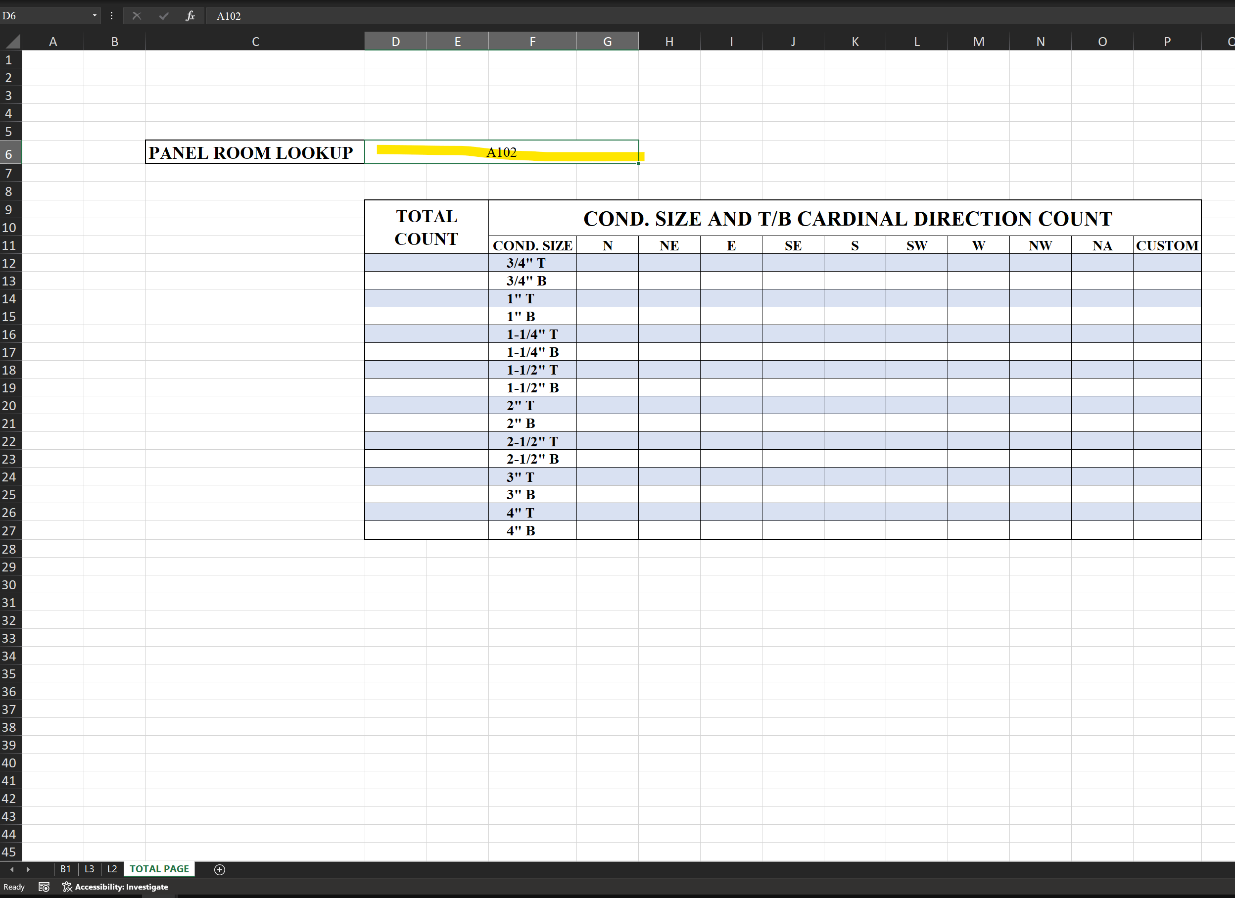

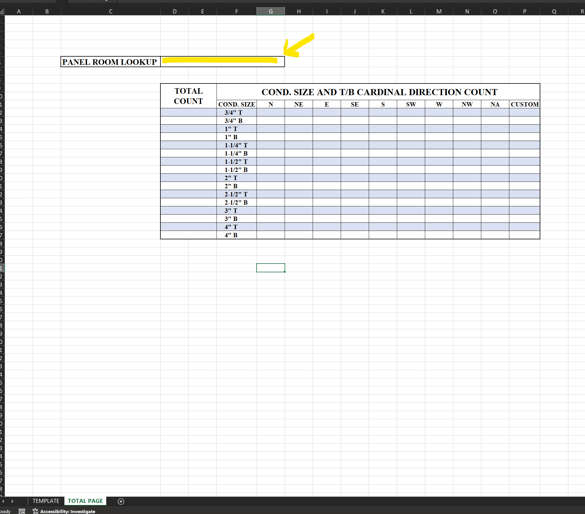

I'm trying to find a way to lookup/search through all the sheets in the workbook and identify panels that are in the same room (using the panel room designation) and then add up the data contained in the highlighted table called COND. SIZE AND T/B CARDINAL DIRECTION COUNT on the same table found on the TOTAL PAGE.
Picture: Generic Panel Information Sheet that will be copied and named the panel name. At the top is where the Electrical Room Number will go. The outlined table (bottom right) is the table I want the data to add up in the TOTAL PAGE sheet based on the Electrical Room Number.
Picture: Here is the TOTAL PAGE where I want to be able to search all sheets for panels that have the same Electrical Room Number and add up their individual data for the following table into the same table in the TOTAL PAGE. This search function would be dynamic so I could search up a different Electrical Room Number and bring up it's corresponding data.

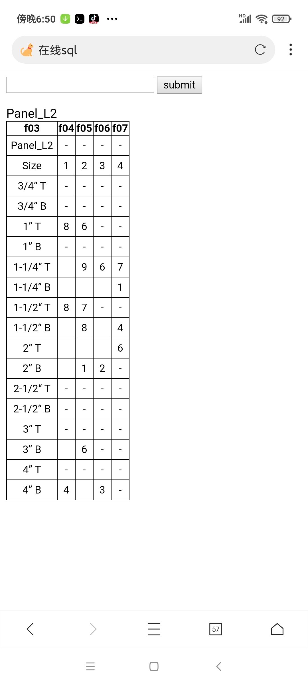

    SQL:
    xli_add_php~~
    <form method=post action="">
    <input type=text name=Panel>
    <button>submit</button>
    </form>
    <?php
    //print_r($_POST);
    if(sizeof($_POST)>0){
    echo $_POST["Panel"];
    $sql=<<<eof
    select colIndex[2:6] from consolidateSheet where f02 in (select f02 from consolidateSheet where f03 like "{$_POST["Panel"]}");
    eof;
    //echo $sql;
    \multiquery\multiquery_run($sql);
    //select * from consolidateSheet;

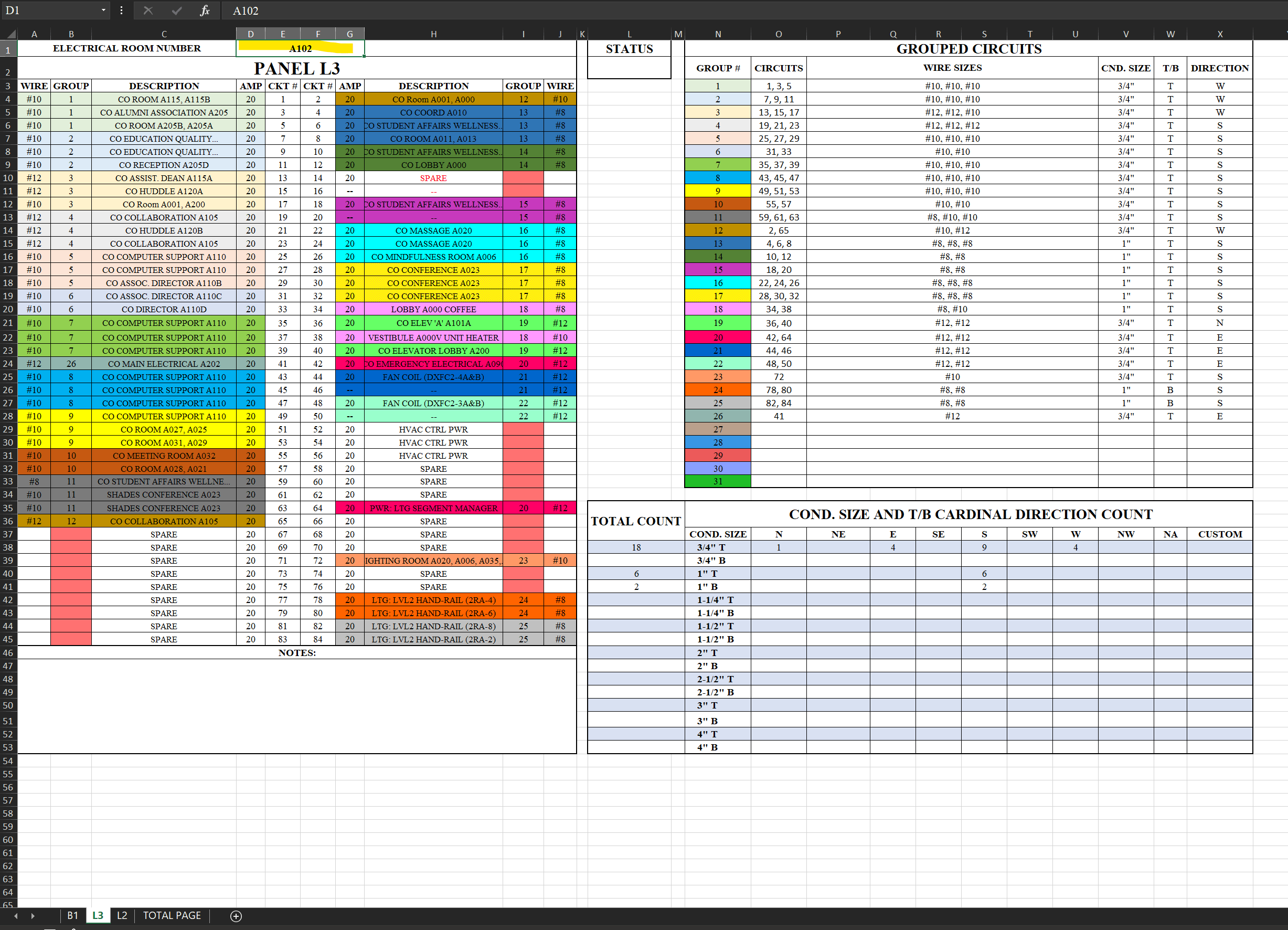

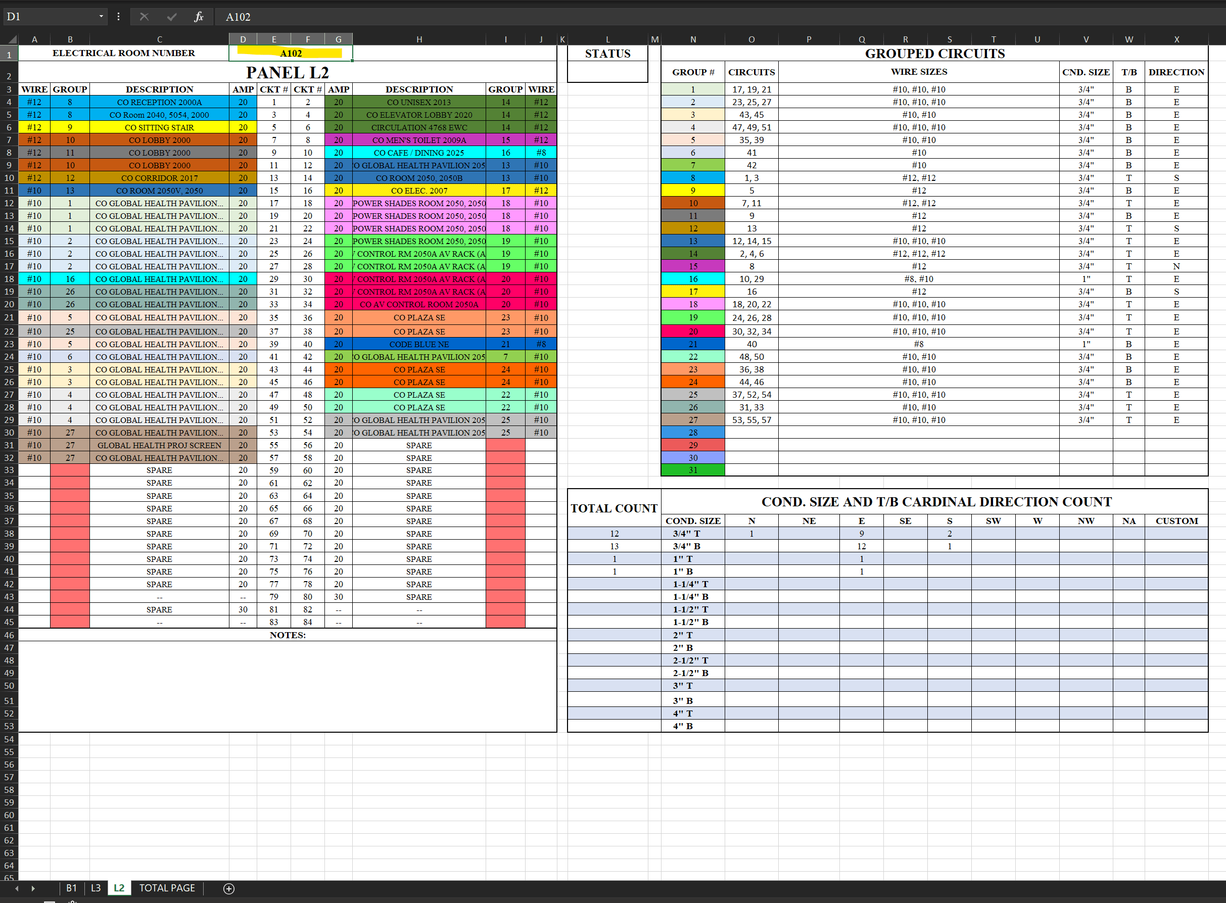

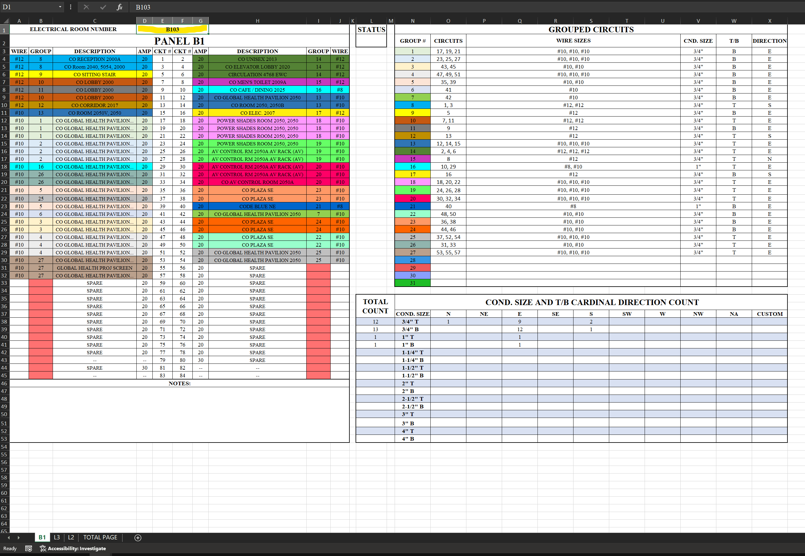

    Thank you for your reply! I was wondering if you could help me again as I am not knowledgeable enough to change your VBA code and follow it. I tried it but it didn't work. The following pictures are an example of what I would normally see and what I'm trying to pull together. You can assume the cells in the picture will be the correct cells to use in the VBA code.
    Sheets L2 and L3 come from the same Electrical Room (A102 shown in D1 of the sheet). I want the data from the table COND. SIZE AND T/B CARDINAL DIRECTION COUNT (Bottom right of the sheets) to be added and show on the same formatted table in the TOTAL PAGE sheet when I look up A102 in cell D6

    Sheet L2:
    Sheet L3:
    Sheet B1: This sheet is here as a panel in another electrical room that I can look up as well in the TOTAL PAGE to search for the totals of the table.
