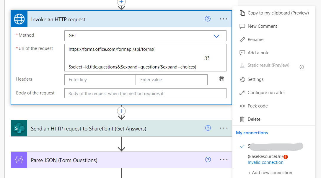

    Good morning, as promised, here are my results:
    Two (2) step process.
    1.
     https://forms.office.com
    1. add the Invoke an Http request (entra), putting this into the URL of the request (nothing below that is needed).
    https://forms.office.com/formapi/api/forms(‘ your form id’)?expand=questions
    Using these, it no longer aborts, but I need to work on the JSON formatting for the questions.  It is very different from the previously working API. I highly recommend opening a ticket with MS if you need.

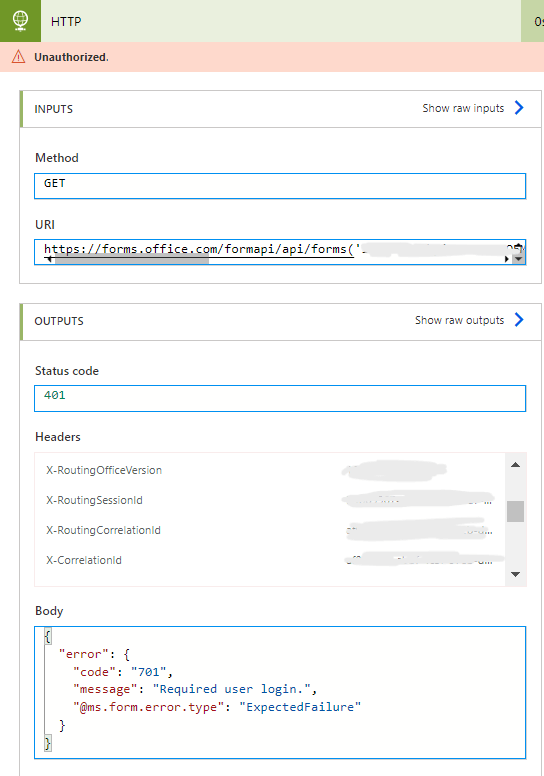

    Great to see there is a workaround, but unfortunately this connector requires a premium license, which I do not have.
    I wondered if this could work with a normal HTTP instead, hence I tried running the request, but it returned error message below.

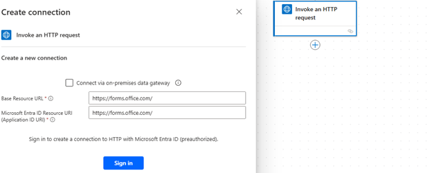

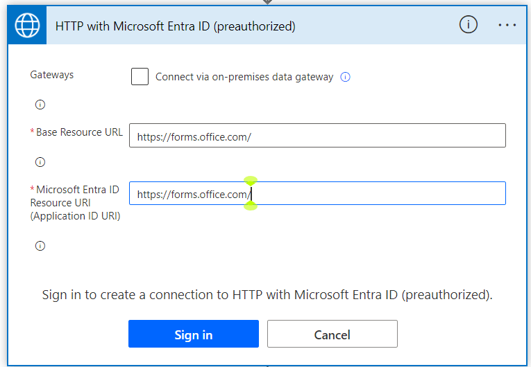

    2024-10-01T17:02:37+00:00
    Hey Xumin, can you try to create the connection first? Click on Add Connection at the bottom of that action - click on ... to see the connections and it'll prompt you. Let me know ok?

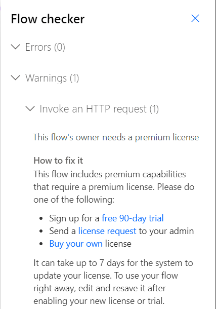

    2024-10-02T00:49:41+00:00
    Hello Joan,
    Great to hear from you.
    I had tried creating the action as per your advise, below is the warning message I get: (email blurred out for privacy)
    And the Flow Checker prompt below:
    Really appreciate your help and guidance on this! Thanks!
