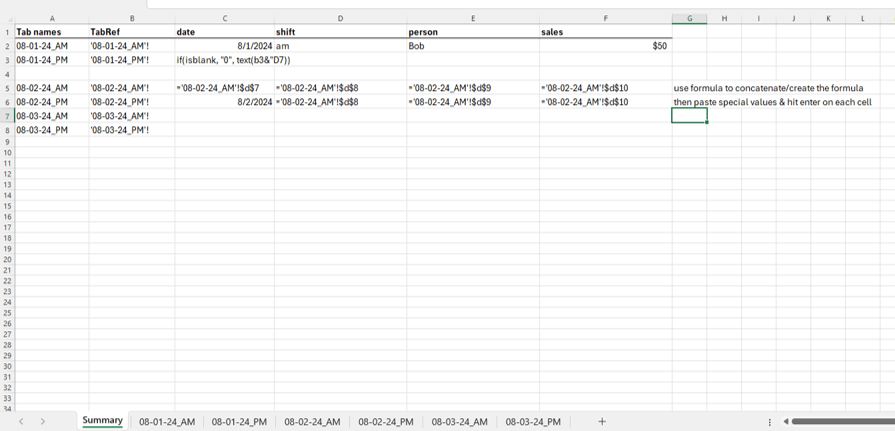

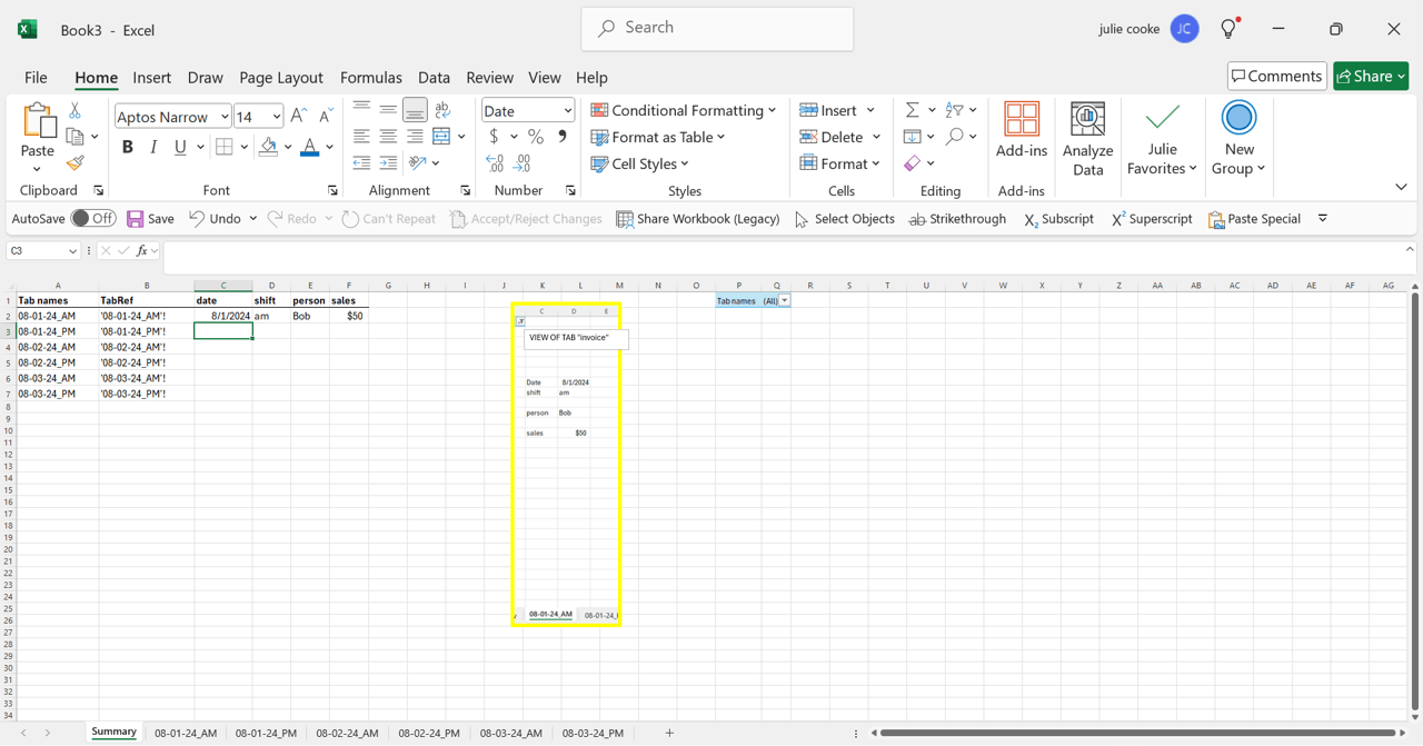

I'm trying to pull data from various tabs in a worksheet. (like each sheet is an invoice (yellow sample) & I want to create a summary page). I'm trying to create the formula to reference a list of the tabs, but can't get the syntax right. I can get it to work by concatenating the parts of the formula, then activating each cell (erase the =, retype it, then hit enter) - but that's too much work for hundreds of instances. It seems like it should be easy & lots of help doing the reverse (making invoices from a dataset), but I can't quite get it - what am I missing? Also, trying to avoid VBA/code to keep it simple for other users.
Edited to add: Here is a screen shot of the & formula that creates the formula (then I copy & paste special values); I just have to go into each cell & hit Enter for the formula to activate.
