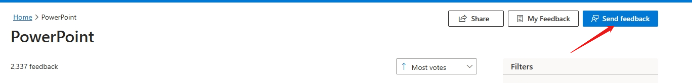

    I sincerely suggest you make your suggestions by filing a report through PowerPoint · Community (microsoft.com).
    Click Send feedback and share more about your issue there.

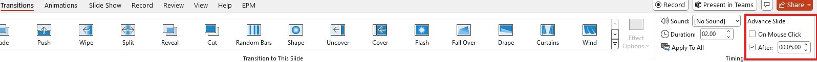

    Additionally, directly set the time for transition to the next slide in the option in the image below.
    In our tests, set in this way and then the "Slide Show" seems to show no issues. If this works, you may record the screen with other software and take this as a workaround.
