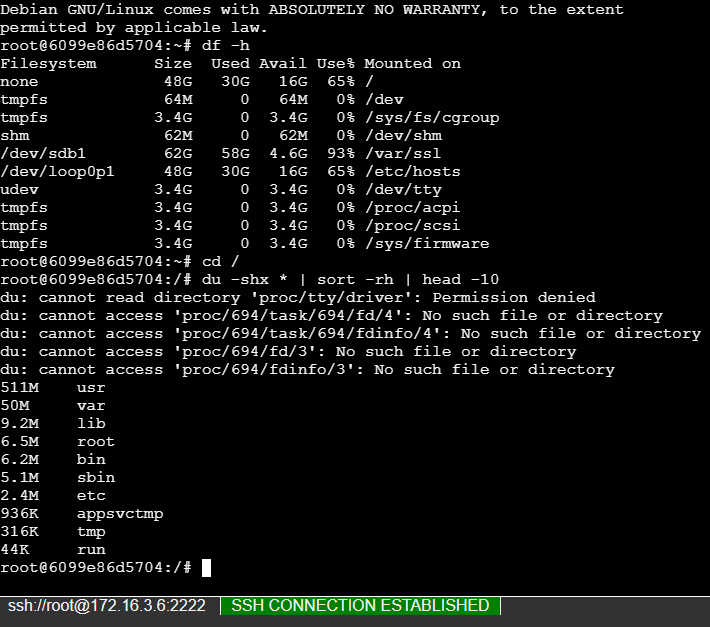

When checking disk usage from inside the container we get the following:

    The size of the app service storage is a bit misleading when using a docker container, what they actually run on is temp storage.
