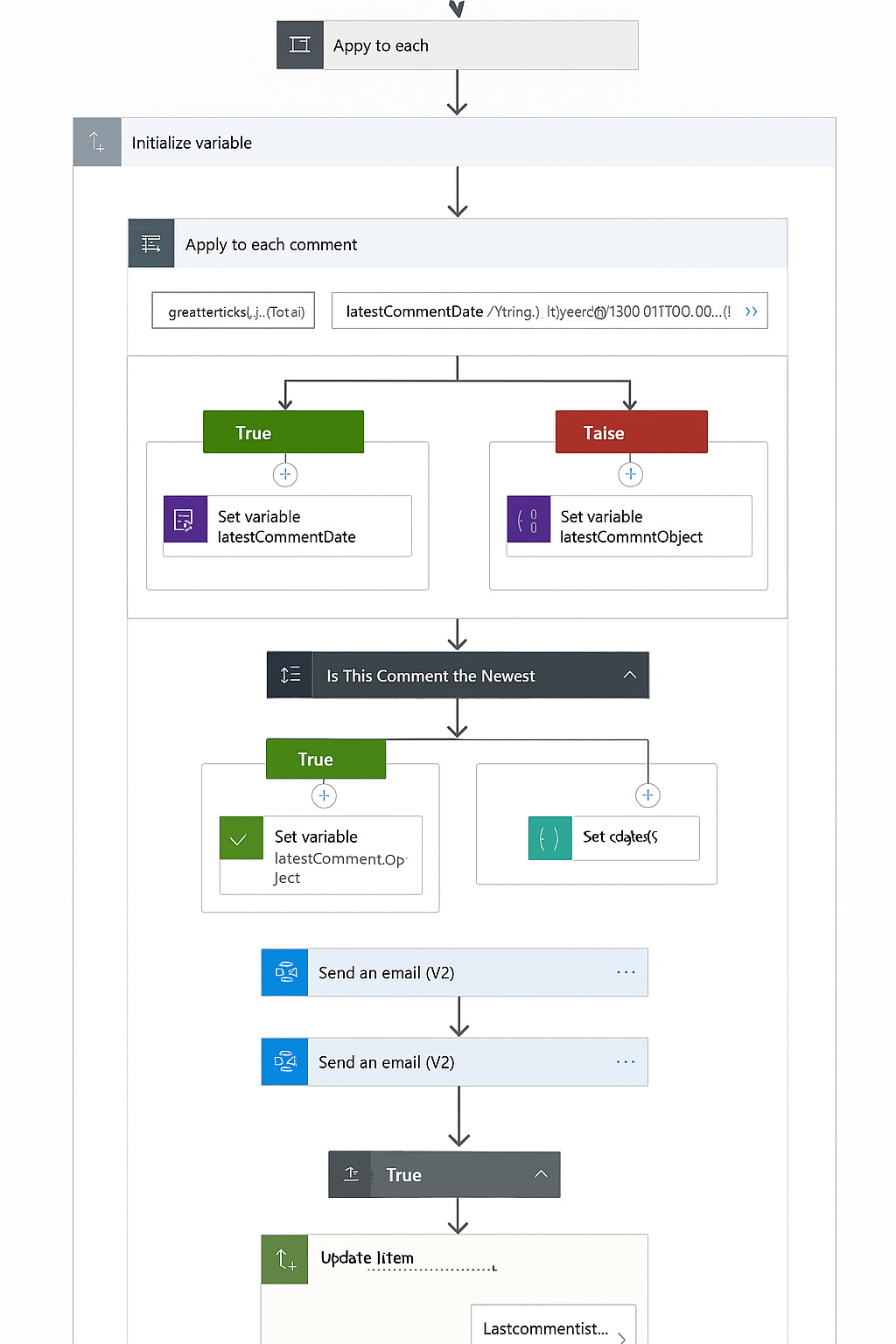

I'm in the process of creating a sharepoint list, that would send an email to the creator of the entry and the person who made the comment via the built in sharepoint comments.
I tried to do it via power automate but ran into some issues where multiple emails are sent, and we only want it sent when a new comment is added.
ChatGPT Image Jul 24, 2025, 03_51_48 PM
ChatGPT Image Jul 24, 2025, 03_52_03 PM
above is a slight design of the intended flow

    The issue you’re encountering is likely caused by the flow looping through all comments without properly filtering out those that have already been processed. Additionally, the timestamp comparison logic may not be accurately identifying only the newest comment, which results in multiple email notifications being triggered.
    Based on your requirements, the intended outcome is to ensure that an email is sent only when a new comment is added to a SharePoint list item. To achieve this, the flow should be designed to compare each comment’s timestamp against a stored value (such as LastCommentTimestamp) and send notifications only if a newer comment is detected.
    We recommend using Power Automate with the following suggestion:
    Trigger the Flow:
    In Power Automate, click Create > Scheduled cloud flow. Set the interval (e.g., every 5 minutes or every hour).
    Click Create.
    This will start your flow on a schedule, regardless of whether a SharePoint item was modified.
    Retrieve the SharePoint Item
    Add the “Get item” action.
    Configure:
    Site Address: your SharePoint site.
    List Name: your list.
    ID: use the ID from the trigger.
    This retrieves the full item including custom columns like LastCommentTimestamp.
    Get Comments via HTTP Request
    Add “Send an HTTP request to SharePoint”.
    Configure:
    Method: GET
    URI: _api/web/lists/getbytitle('YourListName')/items(ItemID)/Comments
    Replace 'YourListName' and ItemID with dynamic values.
    Parse the Comments Add “Parse JSON”.
    Use the output from the HTTP request.
    You can refer this schema:
      "type": "array",
      "items": {
        "type": "object",
        "properties": {
          "createdDateTime": { "type": "string" },
          "text": { "type": "string" },
          "author": {
            "type": "object",
            "properties": {
              "displayName": { "type": "string" },
              "email": { "type": "string" }
    Compare Timestamps Add “Initialize variable”:
    Type: String
    Value: leave blank
    Add “Apply to each” loop: use the parsed comments array.
    Inside the loop:
    Add a condition: comment.createdDateTime > LastCommentTimestamp
    If true:
    Set latestCommentDate to comment.createdDateTime.
    Store comment.author and comment.text in variables.
    Send Notifications
    After the loop, add a condition: latestCommentDate is not empty.
    If true: Add “Send an email (V2)” to the commenter.
    Add another “Send an email (V2)” to the creator.
    Update the SharePoint Item
    Add “Update item”.
    Set LastCommentTimestamp to latestCommentDate.
