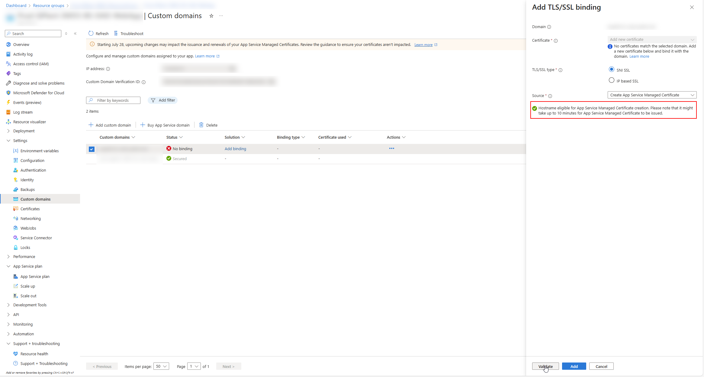

I am trying to create a new managed certificate. I have created hundreds of these before and they are all renewing without a problem.
The domain name validates fine, but adding it eventually times out with this error:
Add App Service Managed Certificate
Error adding managed certificate: Pending managed certificate failed: Request Time-out Refer to the documentations for more info: https://go.microsoft.com/fwlink/?linkid=2158627.
  • I have checked all requirements for creating app service certificates
  • I have checked and run all validation scripts to ensure it passes the new requirements from 28 July 2025
  • i have attempted to create using "az webapp config ssl create ... ". This returns "Managed Certificate creation in progress. Please use the command 'az webapp config ssl show ...' to view your certificate once it is created" - but the certificate is never created
