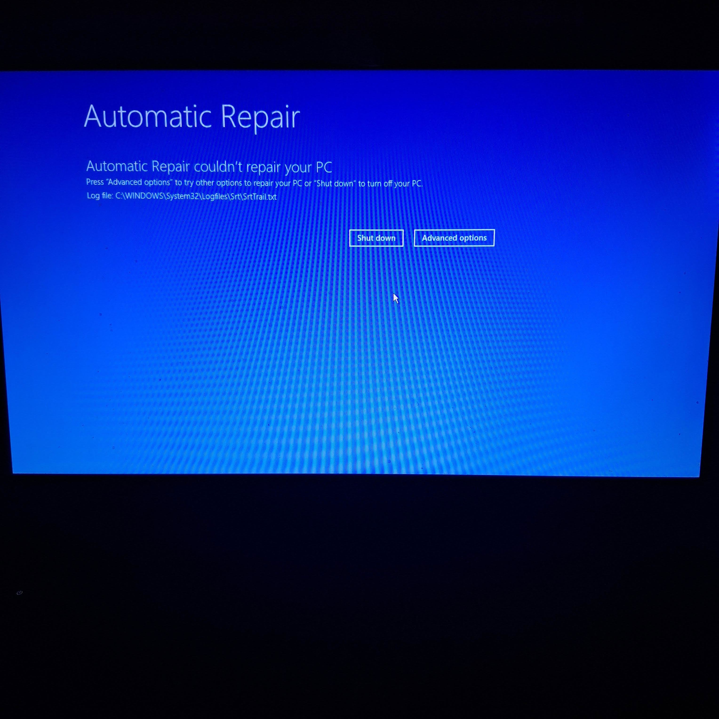

I have a serious issue with windows 10 on my laptop. I hope some one can help me to solve the issue since I have important programs on windows 10.
recently I split just 500 MB free of the drive C(windows 10 ). after splitting I didnot format the 500MB (left it unallocated) and restart the windows to see if everything is ok. then windows ran into issue(did not boot normal, doing some file check/shifting? and stuck long with ETA such things). therefore I rollback the splitted 500MB by partition recovery (MINITOOL) to its original drive C. it worked perfectly without any issue (it means partition recovery detect the lost drive and merge the two neighboring partitions(500MB and drive C together.).
Since then, I cannot boot windows normally.
here are symptoms:
1-I cannot boot windows 10 in normal mode.
2-I have access to windows 10 by safe mode, it means I can log in but I cannot open any folders the following error popup:
The COM+ registry database detected a system error.
2'-I can open other files such *.txt, power iso files etc, they are normally working.
3- in safe mode I cannot run SFC /SCANNOW in command prompt : error "Windows Resource Protection couldnot start the repair service"
4-i dont have access even to start menu/search bar of windows. I open command prompt through task manager (ctrl+alt+del). Through task manager and BROWSE , I can browse normally in folders partitions etc it looks normal.
5-bootrec /fixboot not working in command prompt error: 'Bootrec is not recognized as an internal orexternal command....." same for bootrec /fixmbr
what I have done so far :
I tried repair by windows 10 USB bootable to apply repair through advanced option and command prompt. here what I did
1-restore point not available
2- I applied chkdsk /f /r C: it worked completed.
3-I applied sfc/scannow job finished.
4-bootrec / fixmbr worked and successfull
5- bootrec / fixboot is not working in command : error access is denied
6-bcdedit looks normal .
note: I have 2 windows installed , windows 10 and 11 (on partition G). I can switch to windows 11 on boot up and everything in windows 11 looks normal but every time after logging in windows 11 a popup message at startup shows up**"the recycle bin on drive C (windows 10) is corrupted. do you want to empty the Recylce bin for this drive. Yes,No**". I click yes then everything looks normal; I have normal access to Drive C (windows 10) partition I can browse in the windows 10 folders such as WINDOWS folder /USER / Desktop and all of my desktop files looks untouched and accessible looks completely normal. I can open PDF files txt files exe files already stored in my windows 10 desktop
7- bootrec / fixboot is not working in command : error access is denied
I have normal access through windows 11 to other partitions,
I appreciate if some one can help me to recove/restore windows 10. if there is need to futrher information I am available to share .
