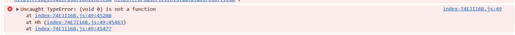

I am using Azure DevOps storage, so I need to use the following code (as shown in the documentation: Azure DevOps Data Storage):
const extDataService = await SDK.getService<IExtensionDataService>(
  CommonServiceIds.ExtensionDataService
import { IExtensionDataService, CommonServiceIds } from "azure-devops-extension-api";
However, I am getting the error shown in the attached screenshot. Could you please provide a solution?

    this often happens due to a timing issue. your code is trying to use the SDK.getService function before the azure devops sdk has fully finished loading on the page.
    the fix is to make sure your code runs only after the sdk is completely ready. wrap your service call in the SDK.init() or SDK.ready() function to ensure everything is loaded.
    try restructuring your code like this.
    SDK.ready().then(async () => { try { const extDataService = await SDK.getService<IExtensionDataService>(CommonServiceIds.ExtensionDataService); // now u can use extDataService safely } catch (error) { console.error("Failed to get service:", error); } });
    this makes sure the sdk is fully initialized before u try to grab the extension data service.
    also, check your import statements. make sure you have the correct npm package installed. u need azure-devops-extension-api for those interfaces.
    if the problem persists, check the browser's developer console for any other errors about missing resources or failed network requests. sometimes a script might fail to load, breaking the whole sdk.

    Hi Leema Rose Priya Sheela,
    Welcome to the Microsoft Q&A Platform! Thank you for asking your question here.
    Could you please confirm if you are still facing the issue. If yes, could you provide below information to assist you further on this.
    • the error details
    • where we are getting the error, during page loading only.
    • share code snippet (you can send via Private message also.)
    • try referring to sample code in which SDK.init() should be done in order to use SDK.getService().
