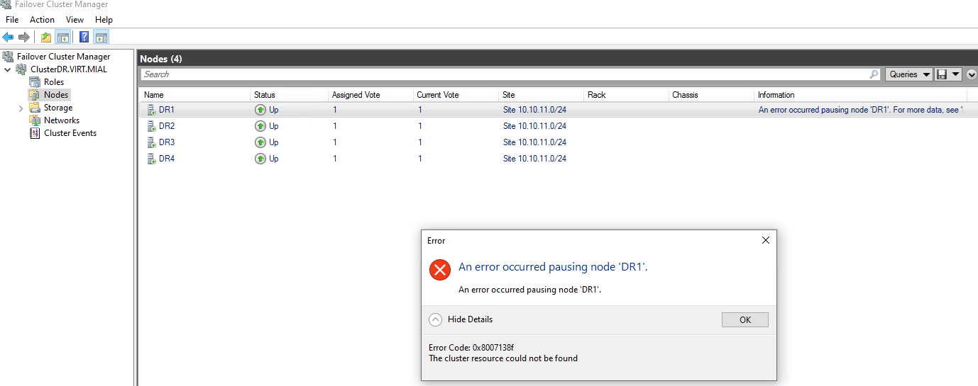

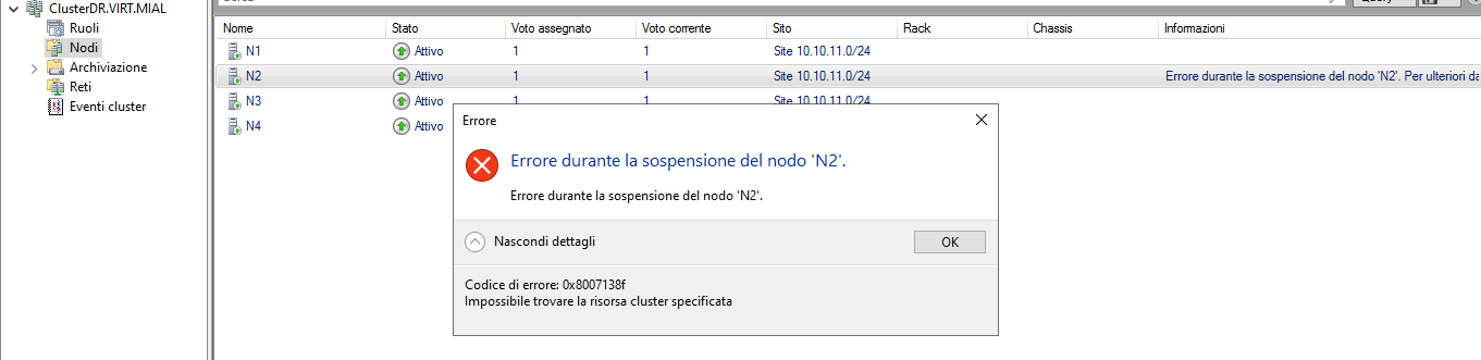

Windows Server 2022 Creato Cluster S2D 4 Nodi dalla voce Ruoli riesco a spostare le vm tra i nodi senza errore.
Quando sono nella Voce Nodi e voglio svuotare i Ruoli per sospendere il nodo ho il messaggio di errore sotto allegato.
Operazioni effettuate:
Eliminato Cluster e Pool e ricreato con nuovo nome Cluster S2D
Fino a quando non ho installato lo storage composto da NVME,SSD,HDD la procedura di sospensione dei nodi funziona correttamente.

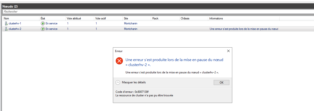

  4. Manuel 1 Reputation point
    2022-02-05T20:12:28.787+00:00
    Same error here with new installed Windows Server 2022 Datacenter Hyperconverged 2-Node-Cluster (german language)
    Suspend-ClusterNode with -ForceDrain is working but i also would like to get that fixed.
    I can find no hints in any eventlog pointing to some cluster-role that causes this error.
    Also the -Verbose option for Suspend-ClusterNode gives no hint to a cause.
    Test-Cluster in powershell also shows no problems.
  5. Yoann Montouchet 16 Reputation points
    2022-02-15T13:10:59.357+00:00
    I can confirm it DOES work for me!
    I renamed that cluster resource (named "Intégrité" here in french) to "Health" and now i can suspend my nodes any way i want without error!!!
    Thanks for providing this feedback!
    Here are the commands i entered through powershell :
    find the name of the cluster resource you have to rename :
    PS C:\Windows\system32> Get-ClusterResource
    Name                                                        State   OwnerGroup               ResourceType
    Intégrité                                                   Online  Groupe SDDC              Health Service
    Actual renaming :
    Get-ClusterResource -Name "Intégrité" | %{ $_.Name = "Health" }
    Now try to suspend your nodes, it should work!
    Hopefully they document this somewhere as lots of people are going to have this issue. Suspending through powershell as i did is also a solution...
    Anyway the issue was found, thanks a lot @Daniel Meyer for providing this explanation and solution!
