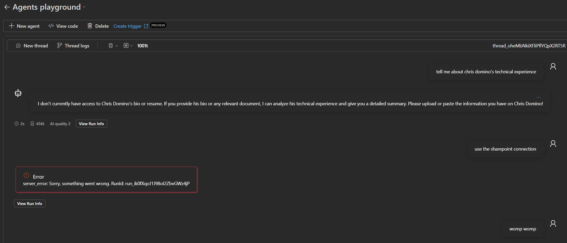

Hello!
Problem Statement

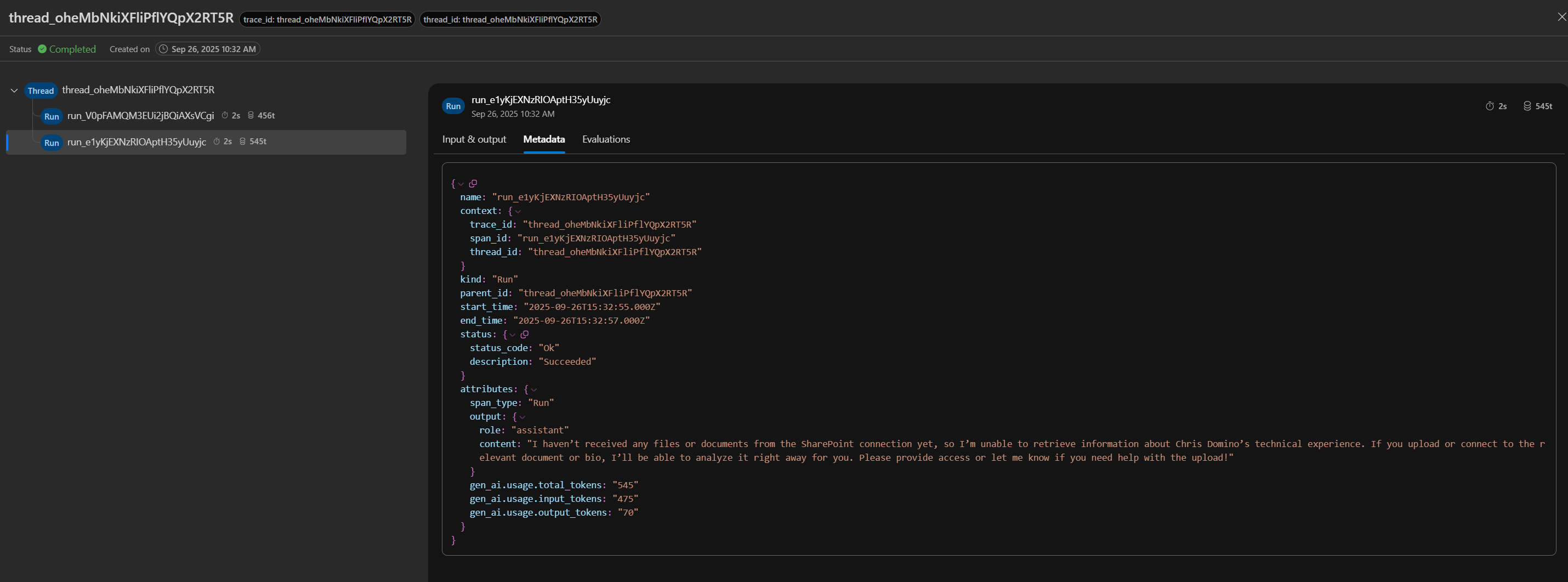

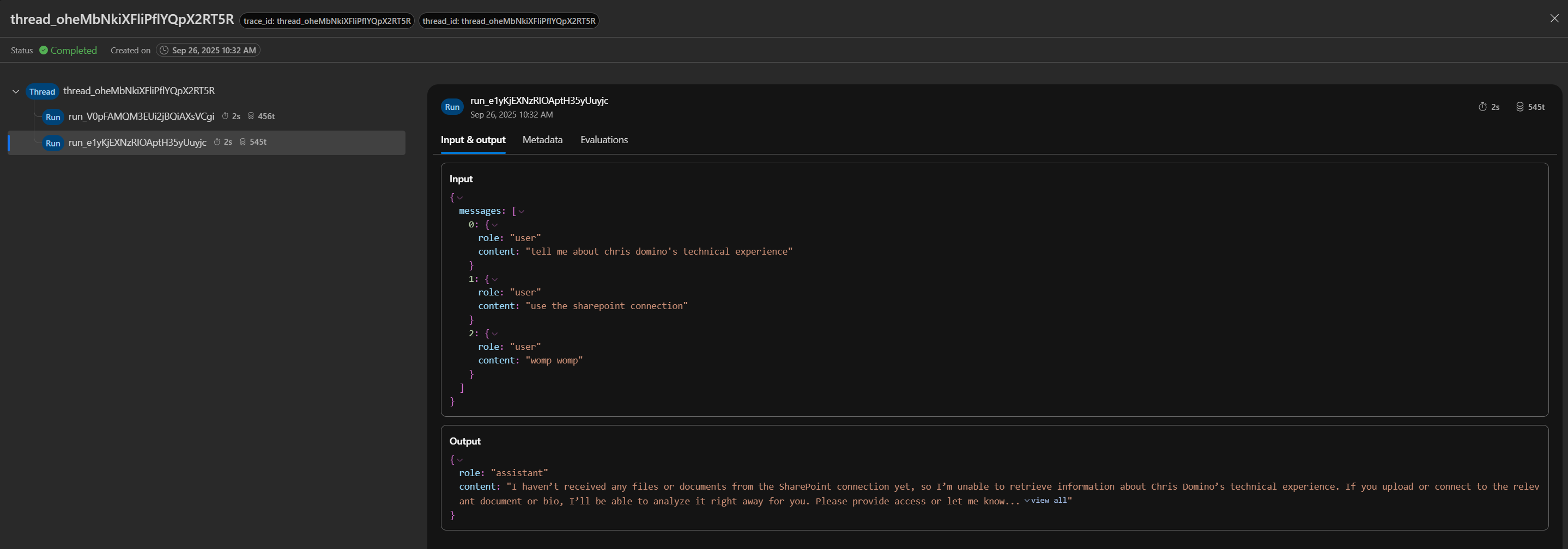

We are experiencing an issue with an Azure AI Foundry Project that has an agent with a SharePoint knowledge connection. All users interacting with this agent in the playground (except folks having global privileged Azure roles) experience it throwing a generic error. I turned on logging, but don't any telemetry providing more details in app insights.
I can't untangle the permissions for the admin users from whom it works. They don't have explicit rights to the SharePoint site (but I do) and do not have any unique Foundry roles. Furthermore, the AI works for these admins even when the Custom Authentication settings (see below) are not attached to an Entra ID app, which why I believe that this is a permission issue.

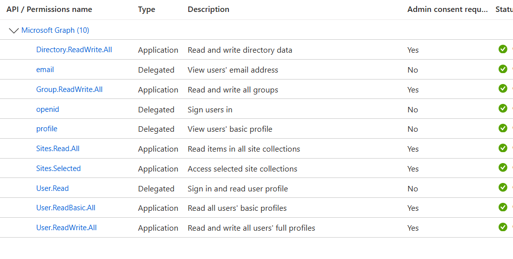

  • Foundry instance and project created via Azure CLI with the following permissions assigned to the project's managed identity as well as an Entra ID app registration.

  • Tried many additional permissions.
  • Added the following keys to the authentication settings for the SharePoint connection per https://learn.microsoft.com/en-us/answers/questions/5552880/unable-to-create-a-sharepoint-connection-in-azure.
    • App Id: <Entra ID app id (guid)>
    • Secret: <Entra ID app registration secret> [marked as a secret]

    • The behavior was different, but throws the same error whenever it tries to use the SharePoint knowledge connection
