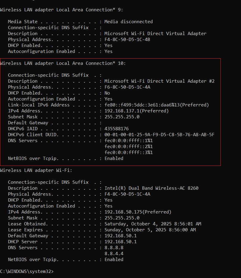

The System event log shows multiple warnings on startup that 'name resolution for website xyz (e.g. www.dropbox.com, c.pki.goog) timed out after none of the configured DNS servers responded'.
When first rebooted my ip configs showed IP6 addresses in addition to the expected IP4.That was new.
The highlighted configuration below with all of the IP6 addresses is new as well.
  • ipconifgAllnew2IP6 is disabled in the wifi adapter for the Intel Wireless-AC8260 wireless card.
  • Disabling the Microsoft Wi-Fi Direct Virtual Adapter does not solve the internet access problem (fixes known issues with the AC8260, but a problem not previously encountered here).
  • Specifying the DNS address on the wireless adapter does not solve the problem. Router is configured to get it's DNS server address from the ISP.

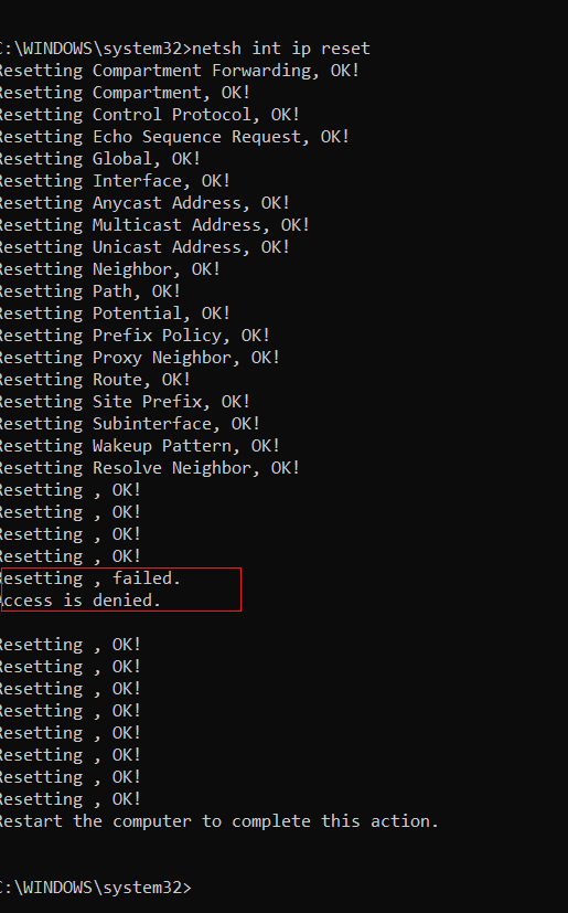

When running netsh int ip reset as administrator I get the following error:

    1. Disable Internet Connection Sharing (ICS) and Mobile Hotspot
    Your system may be stuck in a mode where it tries to share its internet connection (like a hotspot), instead of using the Wi-Fi normally. This can cause misrouting and DNS failures. Steps:
    • Go to Settings > Network & Internet > Mobile Hotspot > Make sure Mobile Hotspot is turned off.
    • Open Control Panel > Network and Sharing Center > Change adapter settings > Right-click your Wi-Fi adapter > Properties > Go to the Sharing tab > Uncheck “Allow other network users to connect through this computer’s internet connection”
    • Look for any Network Bridge or extra adapters (like “Local Area Connection* 10”) > Right-click and Delete or Disable them.
    Disclaimer: Disabling ICS and hotspot features will not affect your ability to connect to Wi-Fi normally. These steps only stop your PC from acting like a router.

    If you see “Access is denied” during netsh int ip reset:
    • Open Registry Editor (regedit)
    • Navigate to: HKEY_LOCAL_MACHINE\SYSTEM\CurrentControlSet\Control\Nsi{eb004a00-9b1a-11d4-9123-0050047759bc}\26
    • Right-click > Permissions > Add your user > Give Full Control
    • Close Registry Editor and re-run the netsh int ip reset command

    Disclaimer: Uninstalling the driver will temporarily disconnect you from Wi-Fi. Windows will reinstall it automatically after reboot. Make sure you have access to another device or offline installer if needed. 5. Verify IP and DNS Settings Your PC may be using incorrect DNS servers or IP addresses, preventing internet access. Steps: After reboot:
    • Open Command Prompt and run: ipconfig /all
    Confirm your Wi-Fi adapter has an IP like 192.168.1.x (not 192.168.137.1) > DNS should be from your router or ISP (not fec0:: addresses)
    Disclaimer: If your IP or DNS still looks incorrect, repeat the reset steps above or manually set DNS to 8.8.8.8 and 1.1.1.1 in your adapter settings. Please understand that our initial response does not always resolve the issue immediately. However, with your help and more detailed information, we can work together to find a solution.

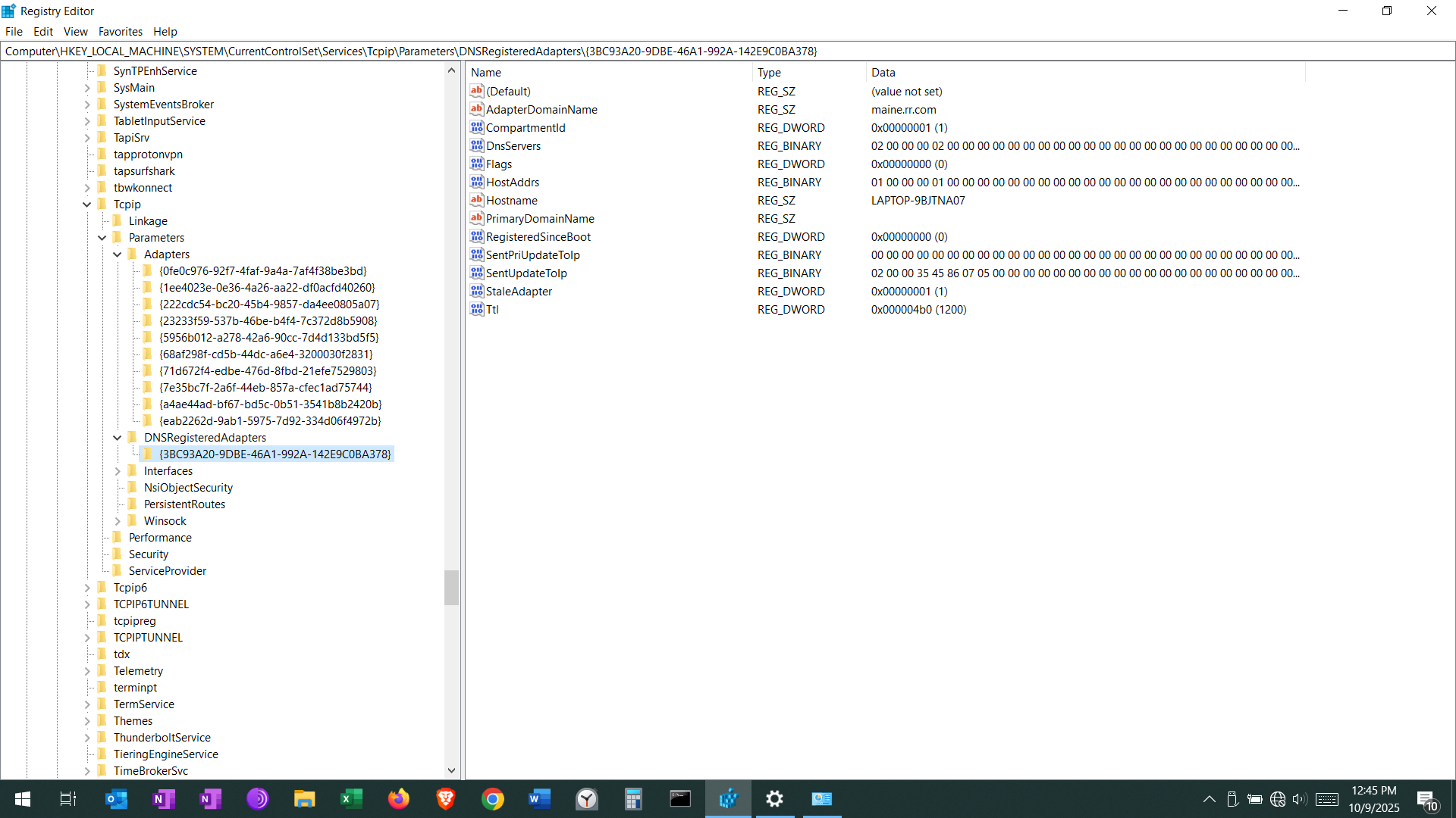

    The machine is connected to the internet. I can ping the IPs for a couple of public websites. Cannot connect to them directly, but I can generate the same Cloudflare direct connect warning on both a connected machine and the problem P50.
    I found a DNSRegisteredAdapters registry value as shown below. Clearing the Register this connections address in DNS checkbox on the Wi-Fi network did not remove the registry entry. I manually deleted it. Not sure where it came from. I do visit Maine but have never had a Road Runner email address for which this was the email domain.
    dns registered adapters2
