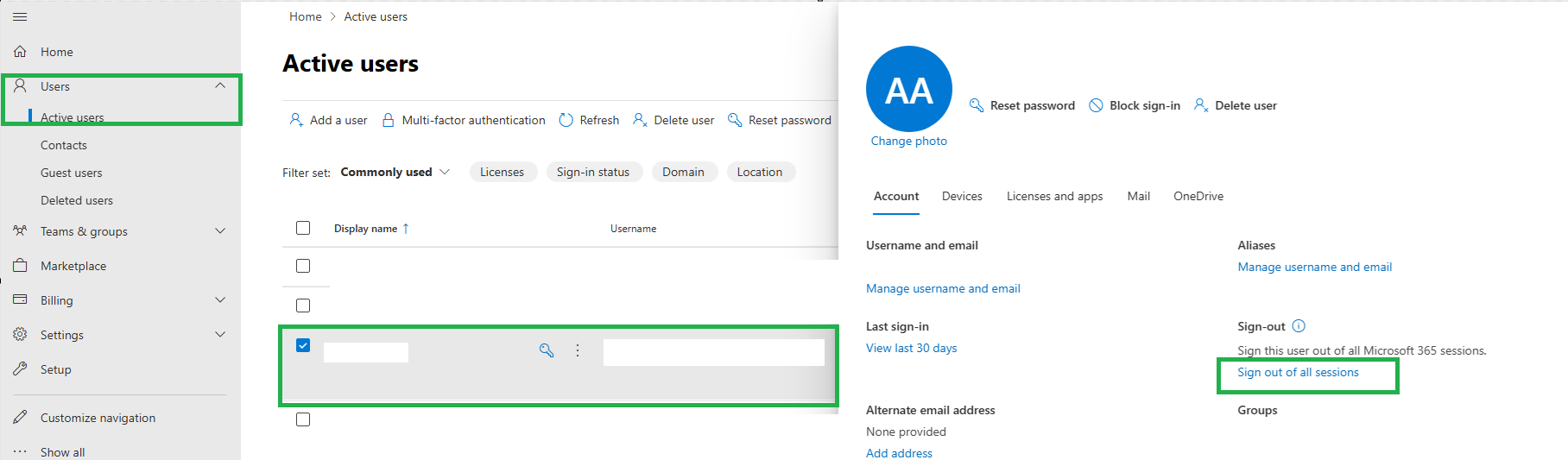

    If this is a work account (managed by your organization), please contact your IT administrator to help you perform the “Sign out of all sessions” action from Microsoft 365 Admin Center.
    Here are steps:
    • They need to go to Microsoft 365 Admin Center. Then, they navigate to Users => Active users and search for and select your username.
    • In the Account section, they find “Sign this user out of all Microsoft 365 sessions” and they click “Sign out of all sessions”.
    After that, on your side, you need to restart your device (computer or phone) to make sure no old sessions are still running in the background.
    Once restarted, you try signing back in to Outlook or Microsoft 365 as usual.

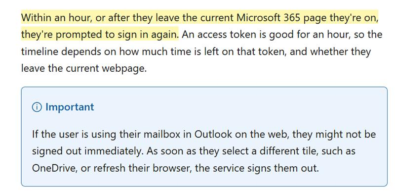

    Note:
    undefined
    For reference: Step 1 - Prevent user sign-in and block access to Microsoft 365
