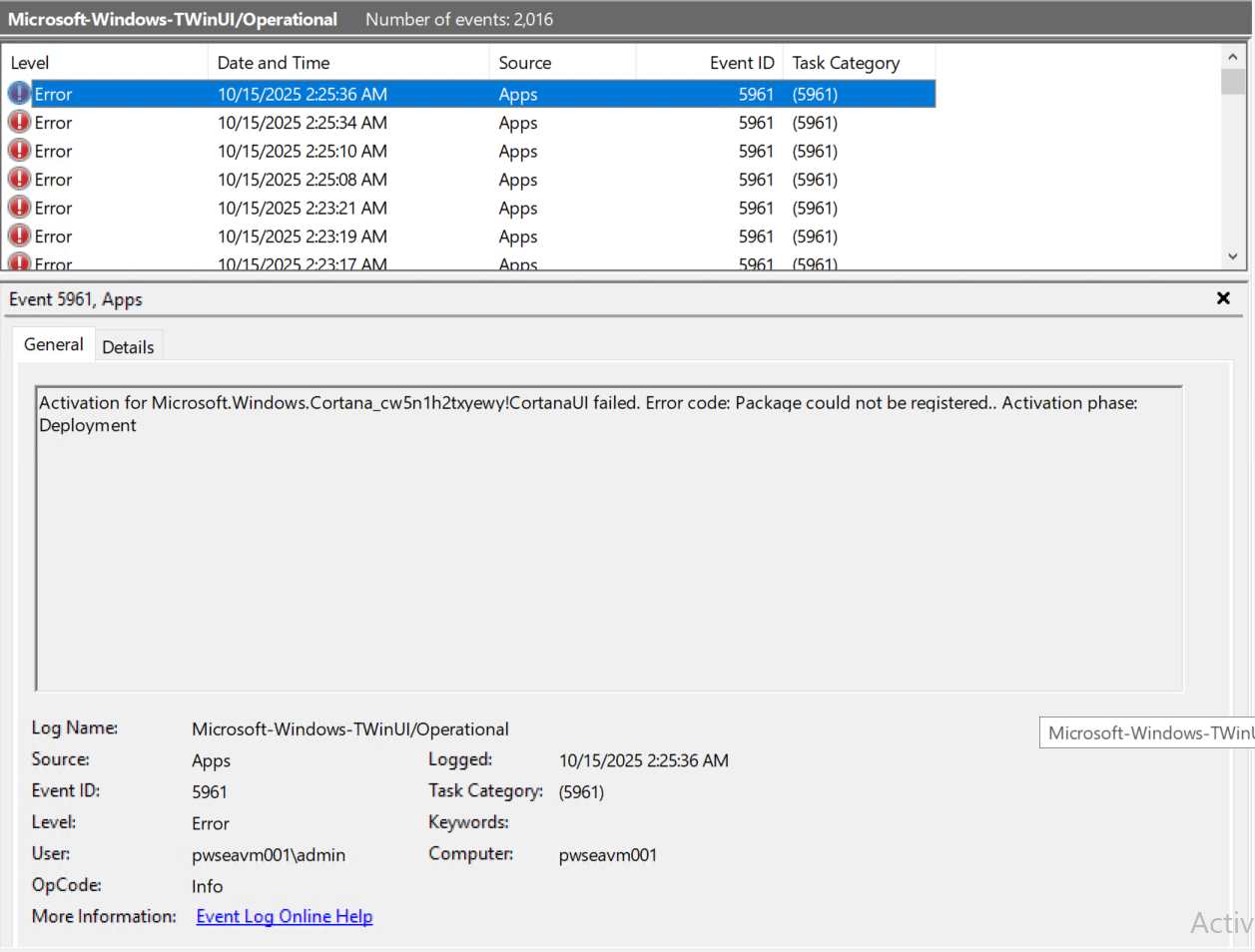

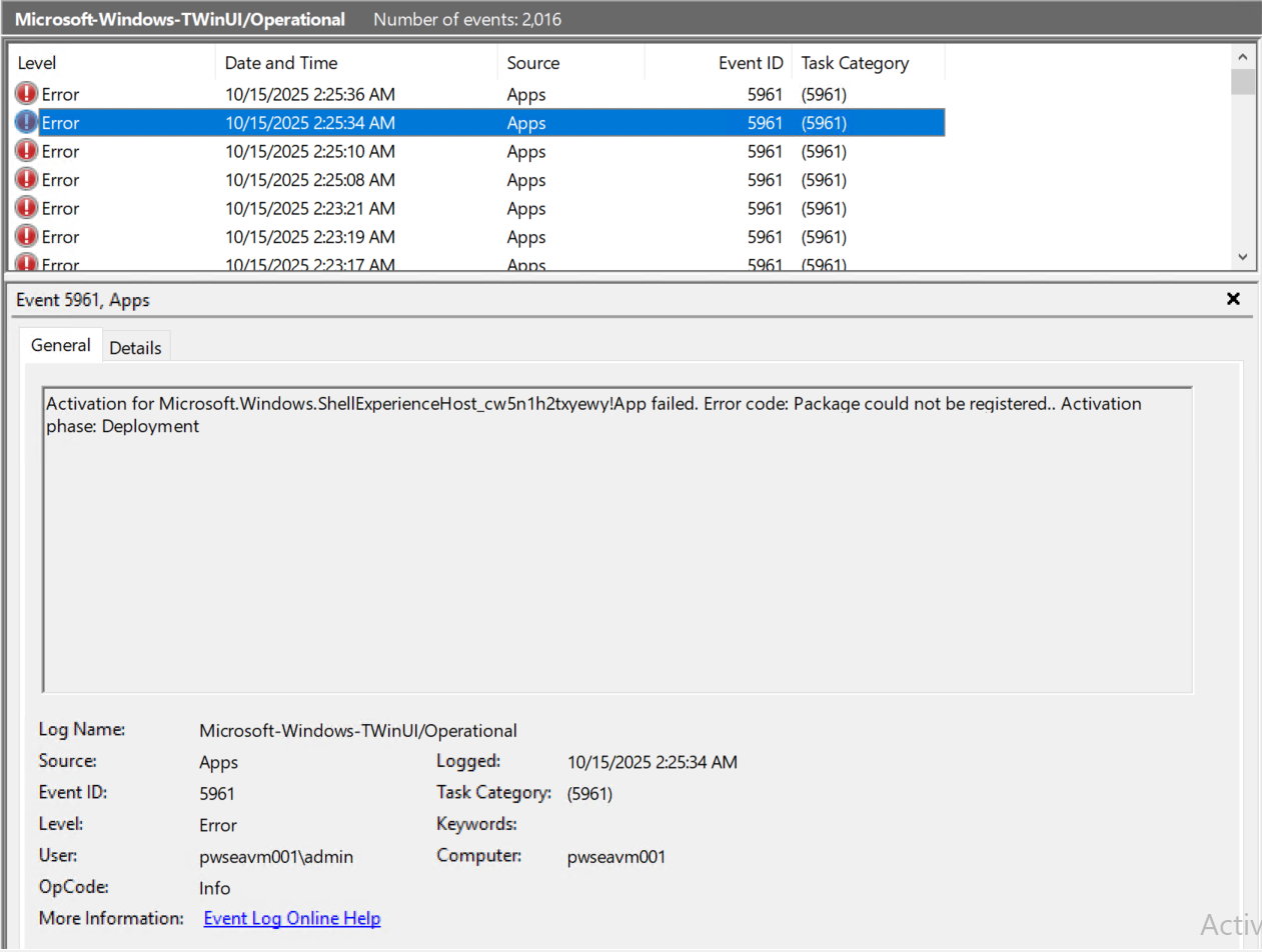

  2. Vivian Phan 6,040 Reputation points Independent Advisor
    2025-10-22T15:22:07.79+00:00
    Hi Sheik Mohamed Yasar,
    I have reviewed the event logs. This suggests a deeper issue with the AppX package deployment or registration process, which is critical for the Start Menu functionality.
    Given that the previous steps did not resolve the issue, and considering this is a Windows Server 2019 instance with Remote Desktop Services (RDS), the problem may be compounded by RDS-specific configurations or a corrupted AppX subsystem. Here’s an updated approach that you can try:
    Verify AppX Package Integrity: The errors point to a failure in registering AppX packages. Let’s manually re-register these components.
    Open an Administrative PowerShell session.
      Run the following command to re-register all built-in Windows apps: Get-AppXPackage -AllUsers | Foreach {Add-AppxPackage -DisableDevelopmentMode -Register "$($_.InstallLocation)\AppXManifest.xml"}
         After completion, restart the server and test with a new user account.

                           **Advanced Troubleshooting with Event Logs**: The recurring Event ID 5961 errors suggest a persistent deployment issue. Enable detailed logging for AppX deployment:
                              Open Event Viewer and navigate to Applications and Services Logs > Microsoft > Windows > AppxDeployment-Server.
                                 Enable logging if it’s disabled, reproduce the issue, and review the logs for more specific error codes or clues.
                                    Share these logs with me if the issue persists for further analysis.
