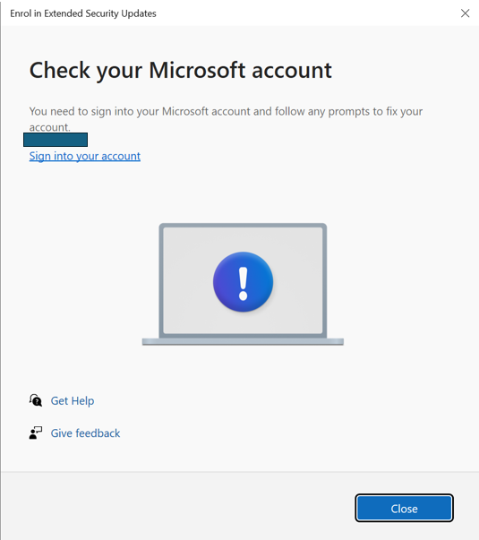

I get the following error - you need to sign in and fix your account.
When I sign in, it takes me to my browser and everything in my account is correct, no error is shown. I have double authentication, account is up to date and the laptop is shown as linked.

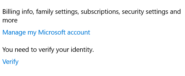

Digging further I find that somehow my account on my laptop needs verification.

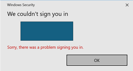

When I press verify, it keeps telling me this:
I am logged in as administrator, have removed a school account . I don't know where else to look. suggestions?

    Sharing it here - I needed to go to Settings - Accounts - Sign-in options and reset/renew my PIN number. (Note - I normally log into Windows with password, not PIN, so hadn't used it since I installed years ago).
    Once that was done, I went back to the security settings and could get ESU.
