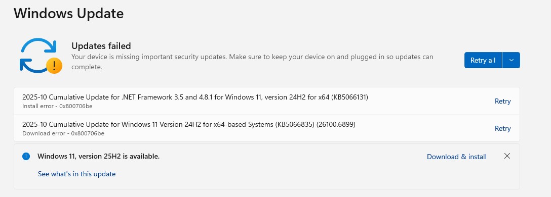

Two important updates will not install. I have tried many times and they always fail. I have tried running the Windows update troubleshooter but I get an error and it fails to run and I am advised to contact support. Your advice would be appreciated.

    Hi Chris, thanks for the detailed explanation. You're definitely not alone—many users have reported issues with Windows 11 25H2 updates failing to install, and even the Windows Update Troubleshooter itself failing to run. Here's a breakdown of what’s going on and how you can move forward.
    Microsoft has acknowledged several problems with recent cumulative updates like KB5066835 and KB5062553, including error codes like 0x80240069, 0x800700c1, 0x800f0991, and 0x8007371b, Update stalls or rollbacks and Troubleshooter crashes or fails to launch properly.
    Recommended Fixes
    1. Use the Windows Update Reset Script
    This resets all update components:
    1. Open Command Prompt as Administrator
    2. Run the following commands one by one:
    net stop wuauserv
    net stop bits
    net stop cryptsvc
    ren C:\Windows\SoftwareDistribution SoftwareDistribution.old
    ren C:\Windows\System32\catroot2 catroot2.old
    net start wuauserv
    net start bits
    net start cryptsvc
    Restart your PC and try the update again.
    1. Install Updates Manually
    - Visit the Microsoft Update Catalog
    - Search for the update code (e.g., KB5066835)
    - Download and run the standalone installer
    1. Run DISM and SFC Tools
    These repair system files that might be blocking updates:
    cmd
    DISM /Online /Cleanup-Image /RestoreHealth
    sfc /scannow
    1. Use the Media Creation Tool for Repair Install
    This keeps your files and apps intact:
    - Download the Media Creation Tool
    - Choose Upgrade this PC now
    - This often bypasses update issues without needing a clean install
    Let me know what happens.

    Method 1/2 Use the Windows Update Reset Script - Failed The updates would still not install.
    Method 3 Install Updates Manually -Failed
    KB5066835 would not install with an error message that it was not compatible with my system
    Searching for KB5066131 brought up a page in Chinese which was too confusing to download
    Method 4 - Run DISM and SFC Tools - Failed SFC would not run with an error message
    Method 5 -Use the Media Creation Tool for Repair Install. - Succeeded! Windows is now up to date and my machine is back to normal and running smoothly.
