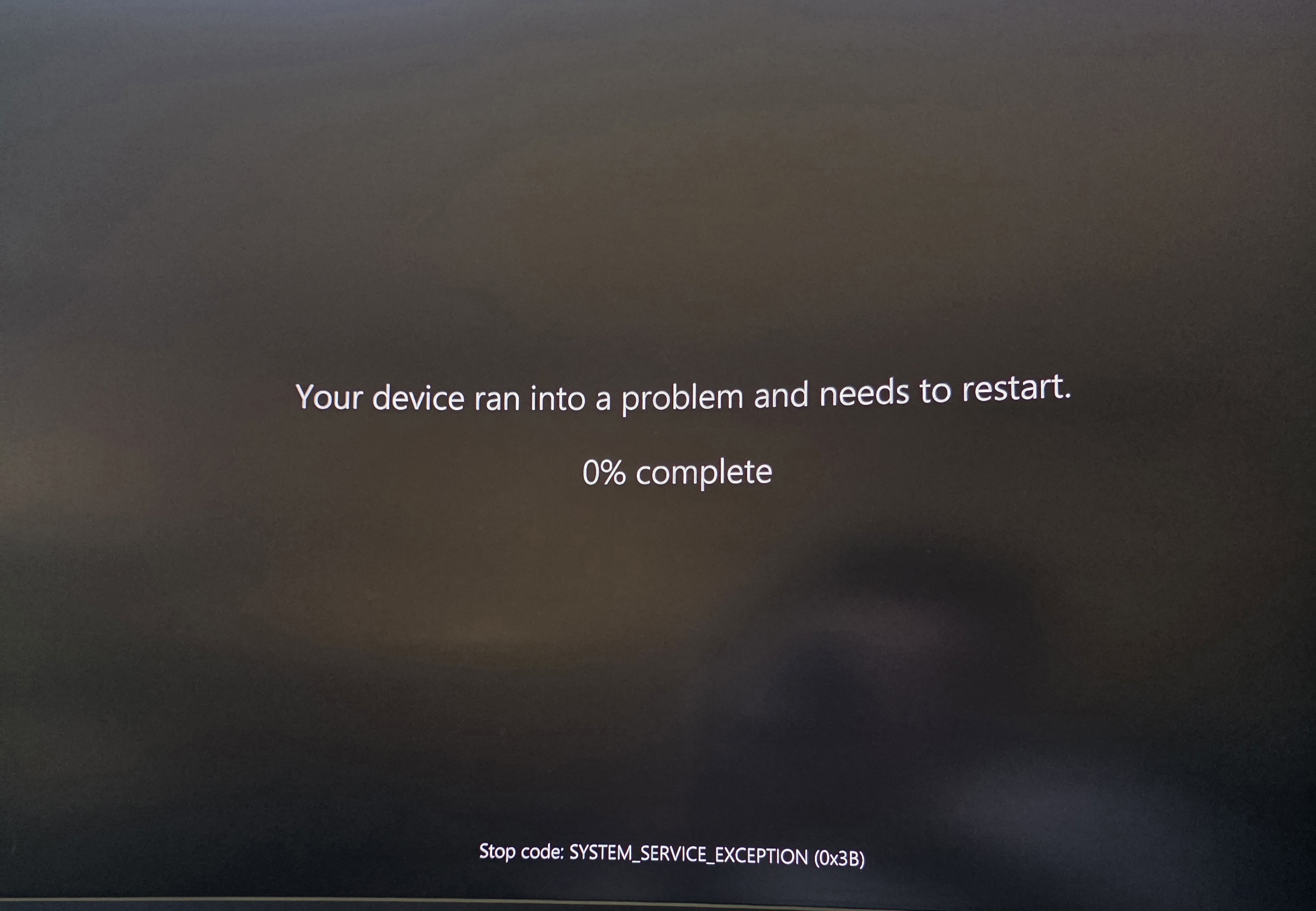

I have an hp omen 30l desktop gt13-1xxx and gone into Bios to turn enable the USB and all of the other stuff thats been recommended, I even removed the battery and let the power drain before starting it up and trying again. It doesn't work. I get the first bitlocker recovery screen which works with keyboard and mouse, then it lets me log into my pc, then it resets my pc and crashes or loops right back into the BitLocker recovery key screen that doesn't let my keyboard or mouse work no matter what I do. I've been to this second screen before a few months ago and the keyboard and mouse worked, but I updated windows a week ago before my pc crashed and one of my friends believe it's a setting that turns off the USB in the BitLocker screen. But the Bios settings didn't fix it like it should've and neither has removing the battery or resetting to defaults. I don't know if there's any way to get the keyboard and mouse to work on this screen without attempting a factory reset on my pc and even then I don't know if I'll be able to fix it - I know my recovery key is the issue. The first recovery key screen works and I can input it, it lets me put the key in and log into my pc, before it says immediately crashes again and goes back to the second recovery key screen that doesn't let my input the code. I inserted the screen of what it shows when I can log into my pc and make it into the home screen before it crashes back into the loop.1000011295

    Based on you provided screenshot, as I checked, the SYSTEM_SERVICE_EXCEPTION (0x3B) stop code often relates to driver or system file corruption.
